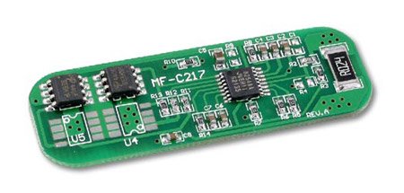

  8. Remember undervoltage is only *one* fault condition for lithium chemistry. Decent battery packs often contain a module with an IC, like the ones posted above, to protect against them *all* faults.
    While you could incorporate protection against each fault separately, or build your own module from a bare IC, you can also buy pre-built modules. To post an example:
    Search Ebay for “battery protection circuit” for a lot more examples, in many different configurations. $3.95 shipped for a tiny one that fits directly on the end of a single 18650 lithium cell. Or ones for up to twelve cells in series, that perform charge balancing as well.
    You might also be able to salvage these modules from old battery packs too.

    Quick question though, some of those ebay ICs allow the battery to drop to a really low voltage, some as low as 2.6v… Is that even re-usable after that point? Fair enough it will stop it fire-balling but will it not start to cut into the capacity at that sort of rundown? I’ve been basing my design on 3.1-3.3 sort of range for cutoff.
