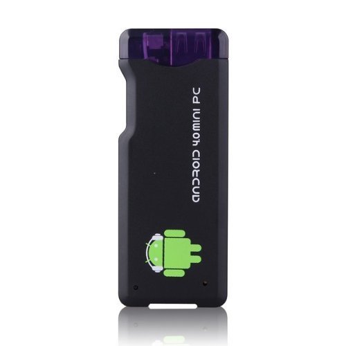

  8. ilikenwf says:
    While it’s wireless, I wonder how using the RasPi would compare to using something like this, as you can run both XBMC and Netflix on Android…
    Then again, I suppose you could run android on the RasPi, but even so, seeing as you can get those “android on stick” devices for $40, I think it may be a better/cheaper option…
    http://www.amazon.com/OEM-SYSTEMS-COMPANY-MK802-Android/dp/B008H3B736/ref=sr_1_3?ie=UTF8&qid=1353364345&sr=8-3&keywords=raspberry+pi

  21. Yoav says:
    Why not buy a $50 Android dongle?
