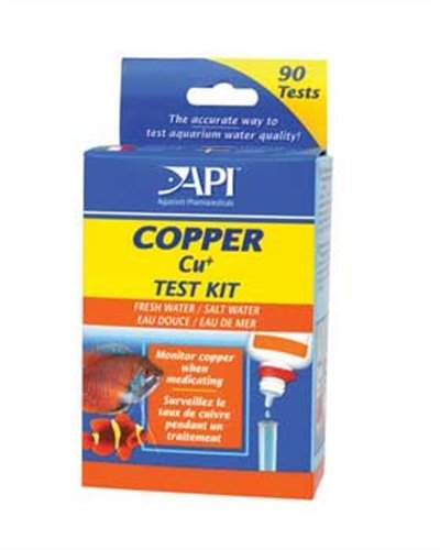

  9. MattyMatt says:
    The materials and coatings are a definite concern, though the pump and other materials appear to be aluminium as stated previously.
    There are a few ways you can check this, a quick search yielded this site: http://www.toxicwatersolution.com/Water-Quality-and-Water-Toxicity/How-to-Test-Water/
    (there is a copper test there, as well as other heavy metals you can test for)
    I’m sure there are many others out there, with probably very similar tests.
    I’ve had all kinds of aquatic creatures over the years… though never axolotls. I am fairly familiar with the chemicals and affects of other chemicals involved with keeping aquatic life happy.
    I would defiantly have some sort of management/monitoring solution so your cool little creatures don’t succumb to heat!
    Either way, great build and keep it up!
    • lrvick says:
      The only copper touching water is thin piece inside the water block at near freezing temps so I expect minimal solubility.
      Just for peace of mind I will be keeping a close eye on the water with this:
      Axolotls also start spotting and having dulled colors as early warning to any copper poising, and their complexion is still very clear and healthy.
      Worst case I mill out an aluminum replacement for that small part at my local hackerspace.
