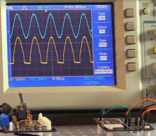

Two applications of a Silicon Diode.
A standard Silicon Diode shown in an AC and DC circuits.
Schottky Diodes are available that offer a lower Forward Voltage Drop than silicon which also means less power dissipation. As a quick visual of the difference between a silicon diode and a Schottky diode we subjected the devices to a 1 volt ramp signal and visually demonstrate the differences as shown below.
Demonstrating a Schottky diode in an AC and DC circuit.
It should be noted that this isn’t a common way to use these devices, this was mostly to show the proportion of a 1 volt signal that the diode selection can affect. In the older days we mostly saw Schottky in RF applications as the low capacitance and fast recovery time worked well at high frequencies.

  4. It would have been clearer if you would have mentioned what the scope was showing Orange = input signal Blue = output across the diode. Also mention where the zero line (it’s a bit hard to tell in the video). Still I found it interesting – a bit of a reminder – thanks
