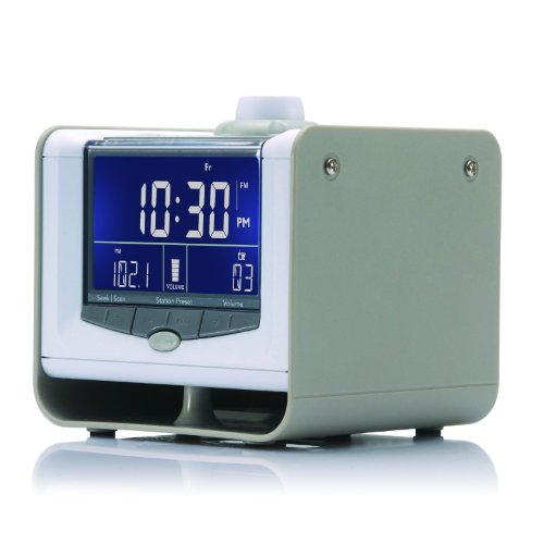

  2. holly_smoke says:
    I have one of these clocks:
    You can set a different alarm for each day, and also multiple alarms for each day. For example if you get up at 6am and the wife needs to get up an hour later.
    Digital radio is very nice too.
