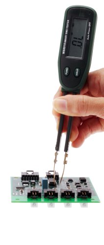

What [Kai] built is an LCR meter, basically a tool that measures inductance, capacitance, and resistance in a very, very small form factor. The technique of measuring a part’s properties involves feeding a set frequency into the device and measuring the phase, voltage and current coming out. It’s all wonderfully explained by [Dave] over at EEVblog in one of his earlier videos.
The hardware [Kai] is using includes an LCD display from a Nokia phone, an MSP430-based microcontroller, a very tiny opamp near the tip of one of the points of the tweezer, and a programmable gain amplifier used to measure the components. In testing, [Kai] can measure very low-value components with a +/- 2% accuracy, and larger, more realistic components with +/- 0.25% accuracy. An awesome accomplishment, and much better than the common Chinese meters that can’t measure in the nH/pF/mΩ range.

  2. Jan says:
    Um, what is wrong with buying tweezers like these:
    http://www.ebay.co.uk/itm/New-SMD-Testing-Tweezers-Probe-Leads-For-Multimeter-Tester-/390481606254?pt=UK_BOI_Electrical_Test_Measurement_Equipment_ET&hash=item5aea84766e
    and using your normal multi-/LCR-meter to measure the components? It is certainly *much* cheaper and less work …
    Jan
    • flink says:
      My meter doesn’t measure capacitance or inductance. Lacking any sort of write up, the tweezers in the ebay link appear to be no more than convenient test leads. Do you have more info?
      Kai’s probe will do inductors, capacitors, resistors, hence its “LCR” moniker.
      But I do appreciate the link to the tweezer probes. I can do with a set.
      • Jan says:
        The tweezers are passive, you need to use them with your own meter (I mentioned that).
        The point of using the tweezers with a good meter is that it is likely going to be more accurate than most things one cobble up at home.
