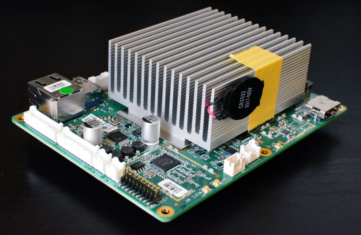

At first glance, the Atomic Pi doesn’t look like your usual single board computer. There’s no power jack or USB port, something that we’ve come to expect on all our little electronic baubles. It seems the Atomic Pi is simply a module meant for a larger product. With this many JST connectors, you would just assume this is a module custom-built for a larger product. Probably not something relating to automotive tech, but at the very least some sort of IoT home goods product. Maybe even a robotic juicer.
Speculation is one thing, and proof is another. Here’s the FCC documentation for the Atomic Pi. This thing was originally designed for the Kuri robot, a ‘home robot’ that was launched at CES in January, 2017. The robot originally cost $700, and was described as, ‘an Amazon Echo with wheels and eyes’.

The Atomic Pi features an Intel Atom x5-Z8350, a quad-core SoC designed for Windows tablets. This is a three-year-old chip clocked at 1.44 GHz (base, up to 1.92 GHz) with 2 GB of RAM. There’s a DirectX 11.2-capable GPU, and overall you’re looking at a system that would have been more than acceptable for desktop use in 2010, sufficient for Outlook and Word in 2015, and something that’ll run emulators in 2020. In other words, if you put this into the context of a desktop computer, you’ll be getting something that plays Fallout 3. Maybe Fortnite. The GPU (Cherry Trail) is supported by Linux, and has support for OpenGL and video decoding. We’re not dealing with a crappy Mali GPU here; this one actually works.
The Atomic Pi isn’t being sold as a tiny brick of a desktop computer with a huge heatsink. This is a single board computer, and any review must place it in the context of being a single board computer. This means it must have some GPIO pins, or some way to blink an LED from the command line. Here, the Atomic Pi is sufficient for limited applications: you get six GPIOs and two UARTs. There are a few additional GPIOs and other ports sprinkled around the board, including a few USB ports on JST connectors. In terms of support for add-ons, external coprocessors, and other connectivity, the Atomic Pi is sufficient. There will never be an entire ecosystem built around add-on boards for the Atomic Pi, but that’s what happens when you only make a few thousand of something.
Power draw topped out right around 7 Watts. I’d suggest at least a 10 Watt / 2 Amp supply.
In terms of software support, the Atomic Pi ships with Ubuntu 18.04.1 LTS; this is simply what you do when you ship a plain vanilla single board computer with Linux — just grab the latest Ubuntu LTS and call it a day. WiFi and Bluetooth work in Linux, although you will need antennas, and neither the WiFi or Bluetooth RF section of the board have metal RF shields installed.
The real question: does the Atomic Pi do Windows? Yes, however Windows 10 is tight on 16 GB of eMMC. To do anything useful, you’ll need to install from an SD card, and with that comes the problems of running an OS from an SD card we see in all single board computers.

Any review, or any consideration at all of the Atomic Pi, must take into account that it will ultimately be a passing mention in a footnote of the history of single board computers. There is no future when there are no more than thirty thousand of these boards to go around. This isn’t necessarily a bad thing, as many impressive builds have started off by finding some discarded equipment on the side of the curb, left out for the trash. But a single board computer is ultimately defined by its ecosystem. With a baked-in production limit, there can be no community. Without a community, there is no future.
If you want a toy, sure, pick up an Atomic Pi. Here’s the link. If it’s out of stock, there’s probably going to be more. But the selling points the Atomic Pi offers — an x86 machine for cheap, with HDMI, that can run Windows — is satisfied by better machines. Take a look at the AcePC T11. This is an x86 box that uses the same chipset as the Atomic Pi, has double the amount of RAM, more eMMC, and support for a SATA drive. It only costs $130, and that gets you a power supply, more than one USB port, WiFi and Bluetooth antennas, and an enclosure. You also get a power supply. Did I mention the AcePC 11 includes a power supply?
Alternatively, if you want the same Intel chip in a pocketable form factor, the AcePC T5 plugs right into an HDMI port. It uses the same Cherry Trail CPU as the Atomic Pi and comes with WiFi and Bluetooth antennas. The AcePC T5 also comes with a power supply and costs only $100.
The price reference for the single board computer market has been set by the Raspberry Pi, and that means thirty five dollars. Right now, I can buy a Pi 3 Model B+ for thirty seven dollars and seventy eight cents, with free one-day delivery from Amazon. Any competitor to the Raspberry Pi must beat it on either price or performance. The OrangePis and their ilk compete on price. The Atomic Pi certainly beats the Pi on performance and meets it on price. However, this is a false economy, as the Atomic Pi is one-off industrial surplus. If that’s your thing, and you need a cheap x86 system, go for it. But there are better options, and you will only save money by confabulating your own power supply if you value your time at zero.
