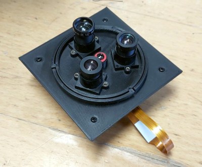

As the art of 3D printing has refined itself over the years, a few accessories have emerged to take prints to the next level. One of them is the threaded insert, a a piece of machined brass designed to be heat-set into a printed hole in the part. They can be placed by hand with a soldering iron, or for the really cool kids, with a purpose-built press. They look great and they can certainly make assembly of a 3D printed structure very easy, but I’m here to tell you they are not as necessary as they might seem. There’s an alternative I have been using for years which does essentially the same job without the drama.
Enter The Self-Tapper
When we think of screws or other fastenings, if we’re not a woodworker, the chances are that it’s a machine screw which comes to mind. A high-precision machined parallel thread, intended to screw into a similarly machined receptacle. Where this is being written they’re mostly metric, in fact I have a small pile of M3 bolts on my desk as I write this, for mounting a Raspberry Pi LCD screen. These are what you would use with those heat-set inserts, and they are generally a very good way to attach parts to each other.
However good an M3 bolt is though, I don’t use them for most of my 3D printing work. Instead, I use self-tapping screws. A self-tapper is a screw with a wide tapering pitch, designed to cut its own thread into a soft material. Most wood screws are self-tappers, as are many screws used for example with aluminium sheet. The material is soft enough for a reliable enough coupling to be made, even if repeated use or over-tightening can destroy it. It’s easy to make 3D prints that can take self-tapping screws in this way, I find it reliable enough for my purposes, and I think it can save you a bunch of time with heat inserts.
How To Make It All Happen
Designing for a self-tapping connection in a 3D print is simplicity itself: a suitable hole for the screw thread to pass through is placed in the upper side, while the lower side has a smaller hole for the thread to bite into. The size of the smaller hole can vary significantly without penalty, but I normally make it the diameter of the shaft of the screw without the thread. A simple example for a 3mm self-tapper in OpenSCAD is shown below, along with a render of the result.
//Screw head end translate([0,0,20]){ //Move upwards to see both parts difference(){ cube([20,20,4]); //screw thread translate([10,10,0]) cylinder(10,1.5,1.5); //screw head translate([10,10,2]) cylinder(10,3,3); } } //Screw thread end difference(){ cube([20,20,10]); translate([10,10,0]) cylinder(10,1,1); // For the screw to bite into }
Assembly follows construction in its simplicity; simply line up both holes and screw the self-tapping screw into them. It should be obvious when the screw is tight enough. Mashing upon it, just like with any other self tapper, risks stripping the thread.
