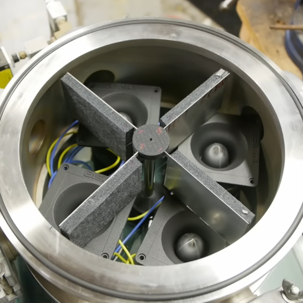

A circular metal vessel is shown, with a symmetrical rotor of four vanes standing inside. At the bottom of the vessel are four loudspeakers.
A Crookes radiometer, despite what many explanations claim, does not work because of radiation pressure. When light strikes the vanes inside the near-vacuum chamber, it heats the vanes, which then impart some extra energy to gas molecules bouncing off of them, causing the vanes to be pushed in the opposite direction. On the other hand, however, it is possible to build a radiometer that spins because of radiation pressure differences, but it’s easier to use acoustic radiation than light.
[Ben Krasnow] built two sets of vanes out of laser-cut aluminium with sound-absorbing foam attached to one side, and mounted the vanes around a jewel bearing taken from an analog voltmeter. He positioned the rotor above four speakers in an acoustically well-sealed chamber, then played 130-decibel white noise on the speakers. The aluminium side of the vanes, which reflected more sound, experienced more pressure than the foam side, causing them to spin. [Ben] tested both sets of vanes, which had the foam mounted on opposite sides, and they spun in opposite directions, which suggests that the pressure difference really was causing them to spin, and not some acoustic streaming effect.
The process of creating such loud sounds burned out a number of speakers, so to prevent this, [Ben] monitored the temperature of a speaker coil at varying amounts of power. He realized that the resistance of the coil increased as it heated up, so by measuring its resistance, he could calculate the coil’s temperature and keep it from getting too hot. [Ben] also tested the radiometer’s performance when the chamber contained other gasses, including hydrogen, helium, carbon dioxide, and sulfur hexafluoride, but none worked as well as air did. It’s a bit counterintuitive that none of these widely-varying gasses worked better than air did, but it makes sense when one considers that speakers are designed to efficiently transfer energy to air.

  2. Fun fact, this effect of measuring the speaker coil temperature and controlling power accordingly is how modern macbook speakers get such loud sound out of such tiny drivers. It’s also why Asahi linux now requires a userspace daemon (speakersafetyd) running all the time to continually calculate the temperature of the coils and feed information back to the kernel. (there’s a safety interlock that prevents sound from working above a massively cut-down level if the daemon isn’t running)
  3. If this rig works like Ben postulates, then he has just invented a propellantless “reactionless” drive rocket.
    Consider the case of a single sealed cavity, with one perfectly absorbing wall facing one perfectly reflecting wall, and the cavity filled with sound. One unit of sound being absorbed by the absorber will yield one unit of force in that direction. One unit of sound bouncing off the reflector will yield, as Ben correctly says, two units of force. But that reflected sound will then get absorbed by the opposite absorbing wall, adding another unit of force it produces.
    The net result is two units of force, in opposite directions, cancelling out. You’ll actually get zero net force.
    It’s the same as filling an airtight box with pressurized air: In a closed box the acoustic force presses equally on all surfaces. Only by letting it out a hole in one wall will you get a net force to push the box.
