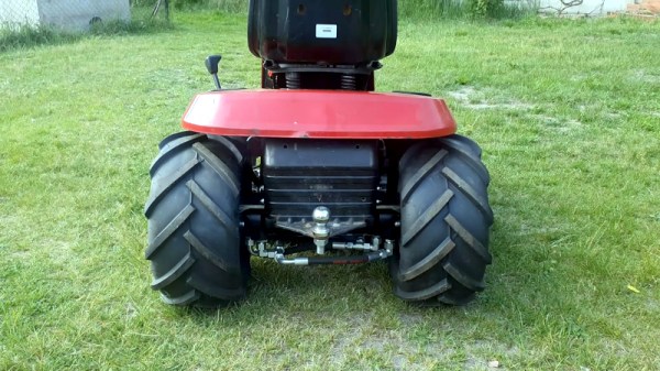

Most larger ride-around landscaping machinery has a similar transmission, a transaxle containing a gearbox, or in some cases, a continuously variable drive. [Made In Garage] has a Toro lawn tractor with just such a setup, and when the transaxle failed he replaced it with a hydraulic drive.
The video below is a classic bit of workshop porn, as he fabricates both the hubs and the rear frame to fit a pair of hydraulic motors. The throttle pedal is a hydraulic valve with the lever swapped for a pedal, and the hydraulic reservoir, in a nice touch, is an old fire extinguisher.
We’re not so sure about the pipework in such an exposed position under the machine as we think it would inevitably be damaged, but you can’t argue with the results. Having used a rough service mower with a hydraulic drive in the past, we appreciate always being exactly at the right ratio for the engine.
