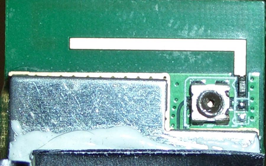

[ronobvious] purchased a Ralink based USB WiFi adapter for use with Aircrack-ng. It worked well so he decided to add an external antenna connector. The connector from Linx Technologies that he chose is really what makes this installation clean. It’s a card-edge design so you just slip it over the end and solder the pin and ground leg. He’s got a link to Tobias Hain’s similar mod and Tobias has a link to a another antenna project as well.

  3. I was thinking of posting a hack similar to this for the USB netgear WG111v2 which has heat issues and could use a signal boost. I stripped off the bulky silver case on mine, coated the bottom with tough epoxy (to protect the components) added a thin, conforming to-220 transistor heatsink (1.5mm profile with bent steel “wings”) to the large hot chip on top and stitched on a panel antenna via inverted U. FL connector (the connector on the device is a female hirose/ U. FL , which is strange since most cards use male type connectors. I overcame this problem by sticking a small slice of a pin in the center of the pigtail. Unfortunately, the ~30ma output power is pathetic. The epoxy and heatsink modifications will extend the life of any usb wifi adaptor, since heat and corrosion can only lead to entropic demise. The best part is, since the profile has been minimized, I can now fit devices in any adjacent usb ports. To attach the heatsink, use thermal epoxy throughout or a combination of thermal paste and regular epoxy (not necessarily mixed together). Do not put epoxy directly on the leads of any complicated looking ICs (ie, +28 tiny pins), since the tiny pF capacitance inherent in most epoxies can affect chip operation (this is not a concern for most chips, don’t worry about it).

  7. @ This is L – I like the heatsink approach, and I considered adding them to cool down the ralink chips in several of my USB adapters. The buggers run way hot and it makes me wonder what the lifespan will be like if I don’t take steps to cool it, but in all likelyhood it will last until it 802.11n hits the shelves ;)
