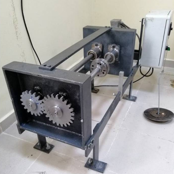

Photograph of the test rig used in the study.
No spin doctoring here, spinning gears.
The authors printed simple test gears in ABS, PLA, and PETG, and built a test rig to run them at 900 rpm with a load of 1.5 Nm against a steel drive gear. The gears were pulled off and weighed every 10,000 rotations, and allowed to run to destruction, which occurred in the hundreds-of-thousands of rotations in each case. The verdict? Well, as you can tell from the image, it’s to use PETG.
The authors think that this is down to PETG’s ductility, so we would have liked to see a hard TPU added to the mix, to say nothing of the engineering filaments. On the other hand, this study was aimed at the most common plastics in the 3D printing world and also verified a theoretical model that can be applied to other polymers.

  3. Nice to see some real life tests on 3D printed gears.
    It would be even nicer if the test apparatus itself was also 3D printed…
    There is also very little info on how it works. How do you apply 1.4Nm at 900rpm?
    The biggest clue is the weight on the right side of the photograph. It probably connects to a string wound around the flywheel in the middle.
    Small calculation: 1.5[Nm] 900[rpm] / 60 [seconds per minute] * (2pi) [Rev -> rad/s] =141 Watts dissipated. This is becoming significant, and probably also the reason the motor speed is so low.
    If I were to design such a tester, I would use thinner axles, that can be used as torsion bars, and then simply use two gear sets, one set at each end. By calibrating the torsion, you can set a constant moment. As a result, you do not have to dissipate any power (except for the friction of the gears and bearings themselves), and you can test two sets of gears at the same time. And you will have to test a batch to get reliable results anyway, so testing two at the same time halves the time for the test.
    1. As a result, you do not have to dissipate any power
      What will provide control of that torsion? Second motor? You will the dissipate that power in your motors. Clutch? You will dissipate that power in that clutch, like in the device used by researchers. It’s standard device used in gear testing. Search for “FZG closed circuit test device”.
      1. the torsion bars themselves.
        just imagine two long axles with identical gears on each end. now you mesh those gear two by two, but instead of just meshing them directly, you twist one of the gears a bit so the next tooth meshes instead of the one directly in front at rest.
        Now instead of that, just imagine in one of the gears you can force turn the axle on the gear, while everything is meshed.
        You’d have gears under constant torsion, but no work done, nor energy being dissipated except the friction of the gears themselves.
        1. Since you are testing for wear, or failure, it is assumed your “load” gears will wear as well. As wear increases, friction becomes less. Thus you have introduced a non-linear load and an unknown.
          1. No. Torque in the torsion bars does not change with “friction”. (Or at least very little). It does change a bit with wear of the gears, because wear reduces the angular displacement of the torsion bar. But depending on the dimensions of the torsion bar this can be minimized to a small value.
            Also, the tests are stopped intermittently to clean the gears and check for wear. And each time the torsion bars can be re-adjusted too. So wear is just a very minor issue. And this method is plenty good for DIY use.
        2. There is more than one way to drown a litter of kittens.
          What advantage does your method provide?
          Besides extra complication?
          Do they even teach KISS in engineering school anymore?
          They hammered us with it.
    2. I had a similar dynamometer application, dissipating about 100 watts. I used a brushed DC motor as the load, varying its load on the rotating shaft through PWM. In principle you can capture that load power and feed it back into the power supply driving the motor under test. I tried, but the buck-boost converter I used didn’t have the dynamic range needed, and 100 W was simple enough to dump into a brake resistor load. For testing the full dynamic range (stopped-full speed) you need to feed current sometimes, so I had to use a four-quadrant drive anyway, which starts to make the thing non-trivial but very useful.
      You could measure torque through the load current (and speed through voltage, FWIW), but I found it was not very precise, and used a separate torque sensor to regulate the load current.
