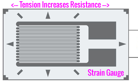

To demonstrate an Instrumentation Amplifier in use in the video, I connect a sensor used in digital scales (known as a load cell) to the instrumentation amplifier and measure the output with my Keithly voltmeter. Since my custom PCB did not come back in time I used one of my two Instrumentation Amplifier evaluation boards I have lying around, this one made by Analog Devices.
A load cell is made from strain gages attached to a metal frame and essentially we are measure very minute changes in length of the copper traces due to the stress on them – a very tiny signal! Also because the gauges act as a voltage divider across 15 volts, the very tiny signal we want is superimposed on top of the relatively huge 7.5V. The ability to strip the huge 7.5V DC signal that is common to both inputs is known as the Common Mode Rejection Ratio and is an important aspect when picking an instrumentation amplifier.
Connecting the load cell to the evaluation board set for a gain of 1000 does give us enough amplification where we can easily see the effects of applying a force to the load cell. As this is a wide band amplifier and there is no real filtering going on you can see what is essentially amplified noise present in the oscilloscope trace.
In a real weighing application there would be judicious use of shielding and some low pass filtering applied to create a consistent DC voltage representing the weight on the load cell.
