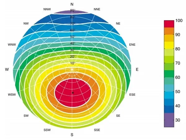

East-West arrays are simple. They consist of parallel strings of PV modules that are oriented in opposing directions, one facing East and the other West. The current of the whole array is the summation of these string currents, effectively letting East-West arrays capture sunlight from dawn till dusk, similar to a tracked array.
So what do you think? Are solar trackers old hat? If you want one, they don’t have to be very complex. But still easier to just double your panels.

  2. The post points out that a tracking setup, of course, will produce more power. That’s not the argument. However, for a given power output, the east-west solution has lower installation costs and uses less land.
    There’s power per panel and power per land area.
    A single-axis tracking row of panels does not need more space than the panels laid flat on the ground, bar a pivot at either ends in the simplest design, but produces something like 25% more power than a fixed array.
    A fixed east/west array collects the exact same amount of energy as a fixed east or fixed west array with the same number of panels – varied orientation just distributes the power output over the day.
    As such, the east/west array will need to pack 20% tighter than the single axis tracker to have the same power output with the same land and even tighter to do so with less land.
    They will pack tightly at very steep angles, but it seems like using them near flat was part of the pitch for its simplicity.
    Considering that any east/west panel configuration could also be made to increase the angle for tracking (e.g., by lifting the top or lowering the bottom, creating gaps), which while less efficient than proper tracking uses no more space than the east/west configuration that was modified, it seems impossible for east/west to be more land effective than a compact tracker.
    Might still be cheaper in some places of course. Although, a fixed panel oriented something other than due east or due west might be much more appropriate at some latitudes and intended load patterns, please check with a solar calculator.
    1. They will pack tightly at very steep angles, but it seems like using them near flat was part of the pitch for its simplicity.
      There is only so much solar irradiance on a given area, if you cover the land 100% with flat laying panels, you get all the energy you can get. By tilting the panels you cast a shadow, from which the next row must stay clear. So (static or dynamic) tilting only increases the output, if you can’t place the panels next to each other in the first place.
  3. It will of course depend on the location, but here in the Netherlands you hardly see tracking systems. A lot of the energy is generated during cloudy days. This reduces much the effect of the theorethical cosine theta reduction. Purely from an irradiation perspective, you loose only about 10 % when laying them flat, compared to oriented at peak angle. You of course would loose self-cleaning. See for example the following graph for angle dependancy. https://voltasolar.nl/wp-content/uploads/opbrengst-instralingsschijf-zonnepanelen.webp
    1. Sorry, I need to correct myself a little. The graph is comparing orientation of fixed positions, it is not comparing to a tracking system. On a quick search I found roughly 20% gain from a tracker compared to a fixed system in the UK, which is at roughly the same latitude an probably has similar cloud coverage. Given the price of a tracker, you better place 20% more panels.
