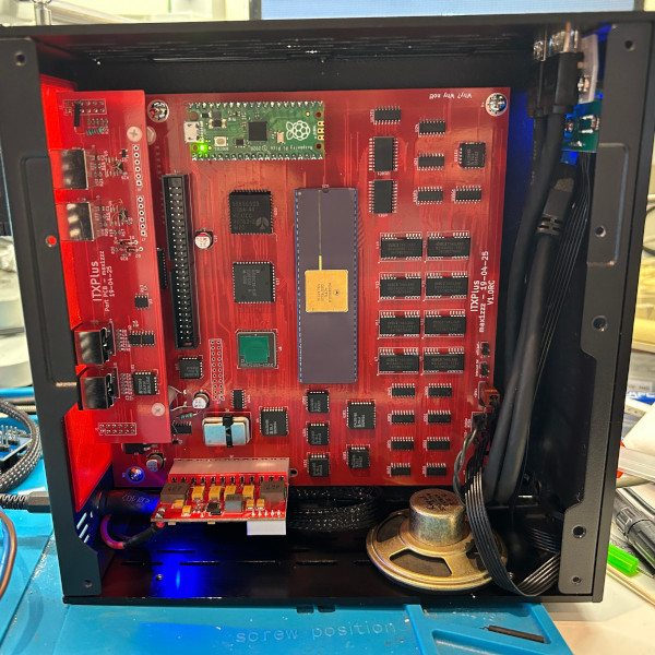

The Macintosh Plus was Apple’s third version on the all-in-one Mac, and for its time it was a veritable powerhouse. If you don’t have one here in 2025 there are a variety of ways to emulate it, but should you wish for something closer to the silicon there’s now [max1zzz]’s all-new Mac Plus motherboard in a mini-ITX form factor to look forward to.
As with other retrocomputing communities, the classic Mac world has seen quite a few projects replacing custom parts with modern equivalents. Thus it has reverse engineered Apple PALs, a replacement for the Sony sound chip, an ATtiny based take on the Mac real-time clock, and a Pi Pico that does VGA conversion. It’s all surface mount save for the connectors and the 68000, purely because a socketed processor allows for one of the gold-and-ceramic packages to be used. The memory is soldered, but with 4 megabytes, this is well-specced for a Mac Plus.
At the moment it’s still in the prototype spin phase, but plenty of work is being done and it shows meaningful progress towards an eventual release to the world. We are impressed, and look forward to the modern takes on a Mac Plus which will inevitably come from it. While you’re waiting, amuse yourself with a lower-spec take on an early Mac.

  1. Sorry to be that guy but relying on a Pi Pico for VGA means it does rely on a special chip. It’s kind of a weird choice too because people have made VGA cards you can build.
    1. or you could throw an FPGA at it. I’ve looked at using them to re-implement gate-for-gate a bunch of different custom apple chips.
      1. Which in turn would mean you could do the whole thing inside said FPGA, but where is the beauty in that?
        Besides, the Pico is an economic choice and not a bad one at that. Software is the new hardware. ;)
        1. You could also not. Sure, I could put your entire desktop computer inside a single chip too, it’s called an SoC. Apple does it a lot these days.
          But I could also say, “this is a gate-for-gate, pin-for-pin replica of an apple chip that actually exists.” Solder it to the same footprint on the board.
    2. I think by “special chip” they mean some custom thing that’s been out of production for years that you’d have to gut a real Mac plus for.
    3. It’s because it has to sample the Mac Plus’s 68K bus for video accesses and then convert them to VGA. So, a standard solution won’t work while the work done on getting a PICO to do that for a Mac Plus (and SE) so that you can connect these computers to VGA is established.
      I was considering that when I needed to fix the blown flyback transformer on my Mac SE, but in the end I obtained a new flyback.
      1. Care to define what you mean by a “standard solution”? Do you mean generating VGA using a microcontroller or something else?
        People have built VGA “cards” from discrete logic chips, so it’s not like doing this with a Pi Pico is the only way.
        1. But it’s by far the cheapest and easiest way. The Pi Pico is $5, and is ubiquitous in the open source retro PC scene because it’s powerful, proven, and easy to implement. Everything from emulated retro graphic cards to sound cards to storage controllers use them. They are the backbone of the efforts to keep old PCs running in an era when parts are scarce and unreliable due to age.
          Making a VGA card from discrete logic chips would cost at least 20x as much, would be much more difficult to to assemble, have dozens more potential points of failure and not give any real benefit, plus relies on parts that may or may not be readily available in the future. Many open source hardware projects that were once in common use are now unable to be assembled because parts that were once common (such as 90s-era LS logic chips and memory modules) are no longer produced, and the ones you can find now are often fake or counterfeit.
    4. I’m willing to cut max1zzz some slack on his VGA interface. Sure, elegance would increase by (eventually) deconstructing the RPi Pico daughter-board into a direct-soldered RP2040 chip, etc. but I don’t think incorporating a “VGA card” will make for a better story. Top “mad scientist” bragging rights are better garnered by adding a real CRT and high-voltage video section. (A good fraction of a MacPlus was its video cleverness). It still makes me smile to imagine my Mac Classic’s 512×342 pixel screen mapped onto a teeny, tiny corner of just one of the 2560×1440 LCDs in my home office.
    5. No kidding.
      Frankly unless it was all built entirely out of the most common 74 series logic chips or even using discrete transistors, I think you could argue that “special chips” are involved. Although it’s understandable that they would use a real Motorola MC68000 given the sheer difficulty of reimplementing that using discrete logic. And it’s silly to emulate it when a chip is available.
    6. Perfection is the enemy of progress. It’s a working computer using a cheap off the shelf part to fix an issue. Any good engineer would see that
