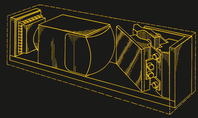

Contrary to our contemporary expectations, the Virtual Boy doesn’t have two screens. In fact, it doesn’t even have one. Instead, the Scanned Linear Array makes use of a single column of LEDs and a rapidly oscillating mirror to project an image into the user’s eye. By scanning back and forth across the eye fast enough, persistence of vision makes the viewer see a complete image.
From Patent 5003300A: “Head Mounted Display for Miniature Video Display System
The Private Eye used a single Scanned Linear Array element to create a 2D image in one eye, but the Virtual Boy featured two identical units to achieve its 3D effect. To bring the cost down, the resolution was dropped to 384Γ—224, which corresponded to a column of 224 tiny LEDs for each eye. Recently The Slow Mo Guys on YouTube captured incredible footage of how the technology actually works inside the Virtual Boy, utilizing some clever video editing to demonstrate how each 1×244 LED array is able to draw out an entire frame of video.

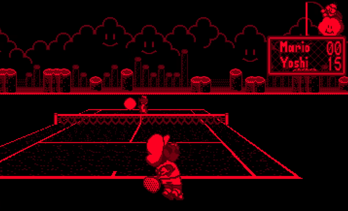

Monochromatic Miscalculation
As impressive as the Scanned Linear Array technology was, it had a critical flaw in that it could only produce an image in shades of red. While technically you could produce a full-color image via this method, it would require a red, green, and blue array for each eye, plus the necessary optics to combine their output.
By the time the Virtual Boy was being developed, blue LEDs were available but they were not yet common, and would have substantially raised the cost of the device. But even if this wasn’t the case, there was no way to fit all six LED arrays and the required optics into the Virtual Boy. As it was, the system was too heavy to wear like a modern VR headset, and needed to be held up to eye level with a tabletop stand. The power consumption would also have been prohibitive — even with just the two LED arrays, the system could only run for approximately four hours on six AA batteries.
Despite these challenges, Nintendo reportedly did experiment with versions of the Virtual Boy that could display more colors. But in the end, just like The Private Eye that came before it, the console was only capable of a red-on-black color scheme that users found unpleasant to view for extended periods of time. As if that wasn’t bad enough for a game system, many players experienced eyestrain from the 3D imagery, and even Nintendo’s own advertisements claimed children under the age of seven shouldn’t use the system due to the potential for eye damage.

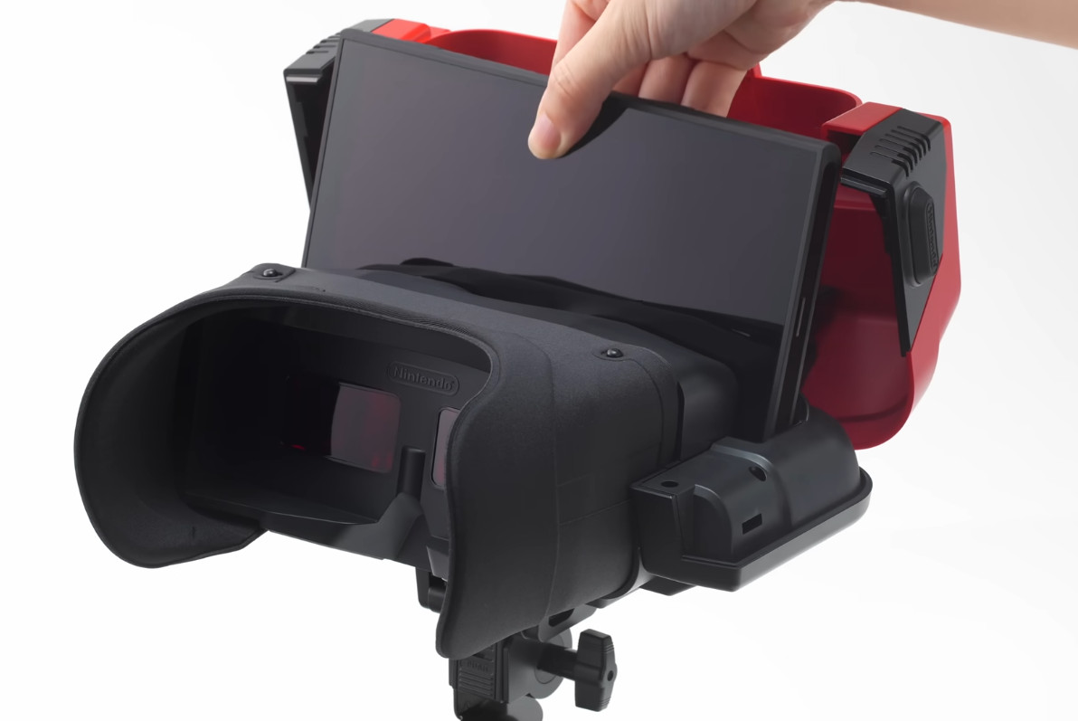

While the Switch support for Virtual Boy games will at least mean these titles get to be played by a larger audience, there’s something bittersweet about how it will work. The Virtual Boy accessory for the Switch is nothing but a hollow plastic shell with a slot for the player to insert their Switch, and for those that don’t want to spend $99, Nintendo says there’ll even be a cardboard version that accomplishes the same goal. Like Google’s phone-based VR offering, all you really need is to hold a couple of lenses and partition off each eye.
All the heavy lifting will be done in software, with the two perspectives on gameplay being displayed in a split-screen fashion. A simple and easy to implement approach that takes advantage of the Switch’s modern high-resolution widescreen display and processing power.
It’s a logical solution to a problem which once took hundreds of dollars worth of custom hardware to solve, and will undoubtedly work even better than the original version. This is especially true since Nintendo has said they plan on adding support for rendering the games in colors other than red.
