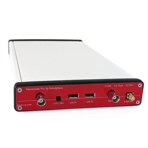

Our hacker [haas] is at it again with the Haasoscope Pro, a full redesign of the original Haasoscope, which was a successful Crowd Supply campaign back in 2018.
This new Pro version was funded on Crowd Supply in April this year and increases the bandwidth from 60 MHz to 2 GHz, the vertical resolution from 8 to 12 bits, and the sample rate from 125 MS/s to 3.2 GS/s. Selling for $999 it claims to be the first open-everything, affordable, high-bandwidth, real-time sampling USB oscilloscope.
The firmware and software are under active development and a new version was released yesterday.
The hardware has an impressive array of features packed into a slick aluminum case with quiet 40 mm internal fan and 220 x 165 x 35 mm (8.66 x 6.5 x 1.38 in) form-factor weighing in at 0.9 kg (1.98 lbs). Also available is an active probe supporting up to 2 GHz analog bandwidth.
The Haasoscope Pro is miles ahead of alternatives such as this USB oscilloscope from back in 2010 and you can find a bunch of support material on GitHub: drandyhaas/HaasoscopePro.

What the heck are you talking about? You can verify the analog bandwidth of a scope beyond Nyquist. The signal just aliases down, but it’s still there.

First: every scope I own and every ADC I’ve ever worked with reports both analog bandwidth and sampling rate. This is totally normal.
It may seem odd to you to have a scope with a bandwidth higher than Nyquist, but it’s totally normal. Scopes normally are heavily oversampled to be user friendly, but it does limit their functionality (and I have ripped out filters to get closer to the analog chain’s max bandwidth). The ADC I’m using now has 4 GHz 3 dB analog bandwidth and 5 GSa/s sampling., which allows you to easily work in the second Nyquist zone of the converter.
You’re clearly used to working with scopes and not signal converters directly. Saying things like “you don’t know if it’s square or sawtooth” – yeah, if I have a signal that only has frequency components up to Nyquist in analog bandwidth it by definition is not a square wave.

Plenty of ADCs have analog bandwidth above Nyquist. There are lots of uses for it, so long as you can isolate the aliasing.
According to the crowdsupply page linked above, the 2 GHz is ‘unlocked’ when using two scopes:
“You can combine two Haasoscope Pro units to achieve 6.4 GS/s on a single channel (unlocking the full 2 GHz bandwidth) or distribute the bandwidth across multiple channels (two channels at 3.2 GS/s each, one at 3.2 GS/s and two at 1.6 GS/s, or four at 1.6 GS/s).”

For the rest, I wanted to have a closer look at the frontend, and what’s actually in it, but the schematic is drawn completely atrocious, with relays presented as an 18 pin dip in the schematic and opamps as rectangular blocs with pins at weird locations. Relays seem to be around bypassable Chebychev filters, but at a glance I can’t even find any gain stage in the signal path.
I am not sure what the target market of this thing is. Best guess is that it’s not intended as an general purpose oscilloscope, but as a special purpose instrument for some specific purpose, but that is not mentioned in the documentation for as far as I could see it (just gave it around 10 minutes of reading).
But still, Mouser lists the whole thing for USD860, and that does seem quite low considering the cost of the ADC alone. There may be a market for this thing, (but it’s not for me).

I’m not sure why you think this isn’t a general purpose scope. That’s definitely the goal – although clearly specialized for high bandwidth.
I wrote lots of project logs here on Hackaday.io…
https://hackaday.io/project/200773/logs
There’s one in particular on the front end so you can understand the signal chain there…
https://hackaday.io/project/200773-haasoscope-pro/log/236963-walkthrough-of-the-front-end-design
Feel free to reach out on there if you have any questions!
Yes, this amazingly affordable ADC was key:

And again, still without a decent analog frontend (max 3V input in 1MOhm input mode, according to the hackaday project. And an 8mV/div sensitivity is also pretty abysmal.

To clarify, it’s +-30V in 1 MOhm mode with a 10:1 probe. Also, since it’s 12-bits, that’s equivalent to a 16x better sensitivity than an 8-bit scope, so 8 mV/div is really more like 500 uV/div since you can zoom in digitally. These are pretty standard specs, I think.
Thanks for your thoughts about the software trigger stabilizer. I’ll consider updating it soon to be even more precise when sinc upsampling is being done.
Well, no, “digitally zoom in” does not cut it, sorry. The sparkle of 12B ADCs just isn’t there in an old 8B ADC. It’s not the same. While it’s OK to not support higher input voltages at the scope itself, as they are unviable at high bandwidths, I find it odd to pair this with a High-Z input. It’s either High-Z and High-Voltage or none of them. High-Z + Low-Voltage is just begging for people to break the input.
Also, there is no separate trigger circuit with time-to-digital conversion. So the sub-sample time of the trigger is lost, so the sample that matched the trigger will jump around, and so will the whole captured signal. That’s only OK in a streaming architecture or maybe in a single-shot architecture. Yet usually a scope overlays many captures to capture rare effects. You’ll have to bend over backwards to support this, and play tricks like correlate the captures to overlay them properly (yet, that’s just a guess about the signal and nothing real).
