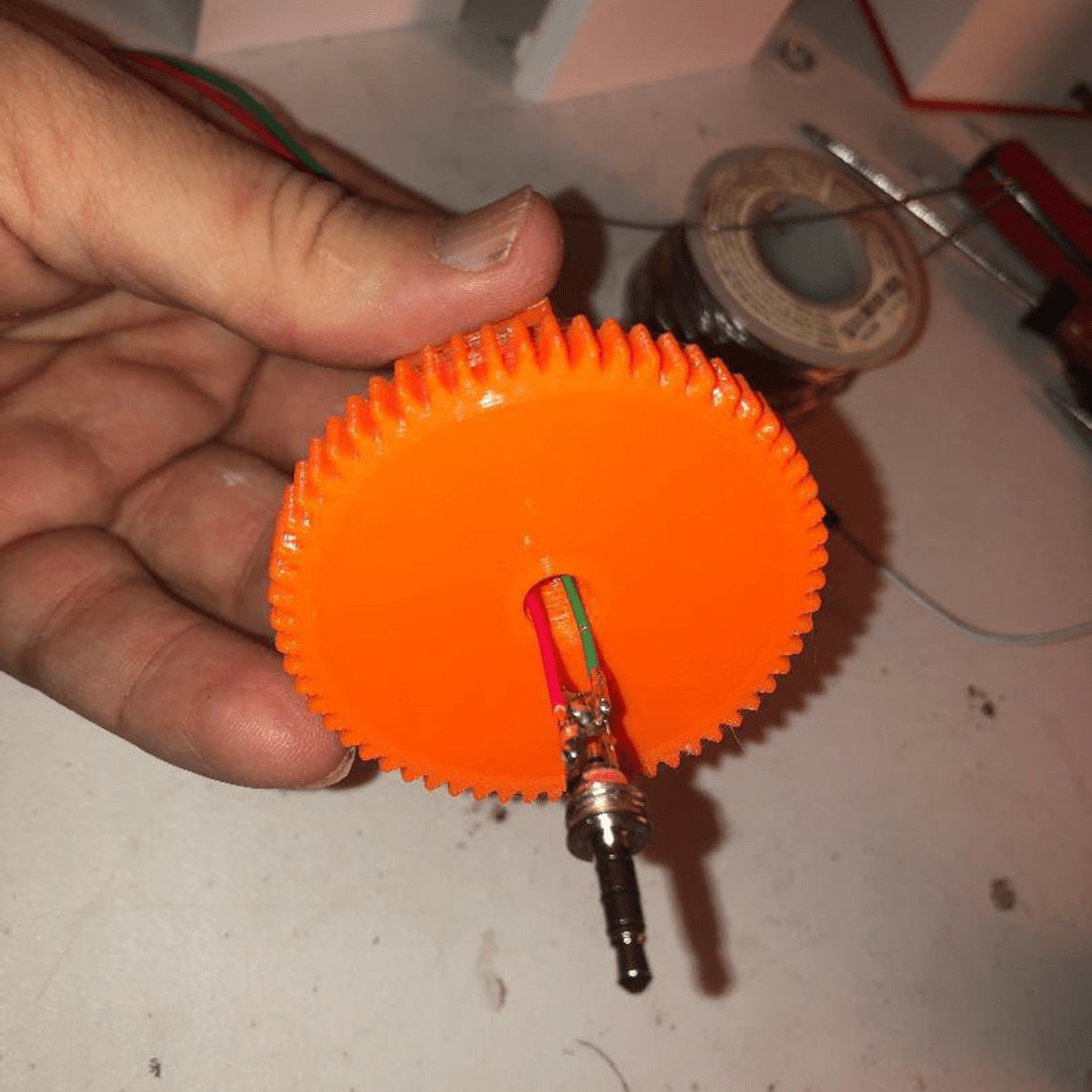

[Luke J. Barker]’s Need an Electrical Slip Ring? is simplicity itself, and appears to have been born of the mother of invention. [Luke] was making a VertiBird helicopter toy, which spins around on the desk and rises and falls with joystick control. And for that, he needed a slip ring. Enter the humble audio jack, which fills the job nicely, transmitting power to the rotating helicopter without twisting up wires in the process. There’s not much magic here, but it’s a fantastic idea when you need something to spin.

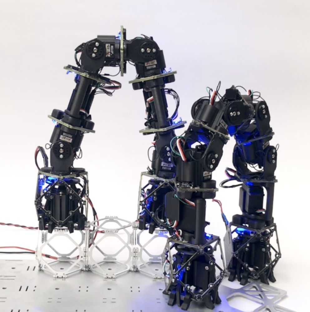

Or maybe you’re working on self-assembling robots and you need some magic glue to hold different modules together. [Miana]’s Low-melt-solder connected robots is half research project, and half hack. Resistors are used to melt solder, magnets align the parts together, and when it all cools down, it’s as if two modules are brazed together. This one’s a lot more than a hack, but we’re honored to have it entered in the contest anyway!

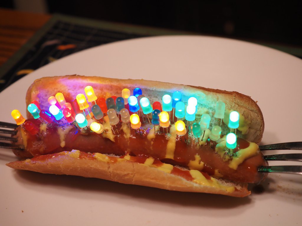

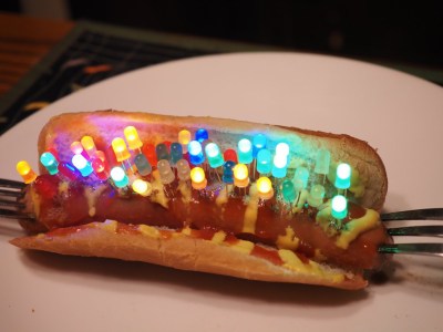

Everything is a fuse if you run enough current through it. [JohnsonFarms] pushed conductive filament to the melting point, and calibrated it along the way. While roasting a hotdog with mains voltage and a couple forks, [Ian Dunn] discovered that if you stick some LEDs in it, they light up.
