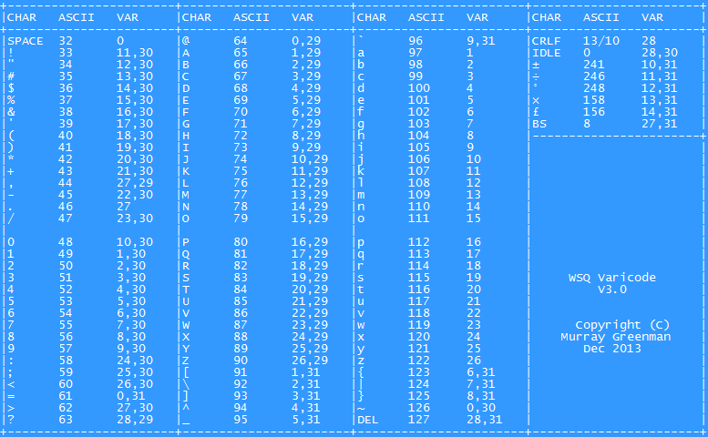

  3. Base 16/32/64 encode UTF-8 if you want. Could transfer binary data that way, too.
    “The FSQ alphabet has 29 characters that can be sent as a single symbol (all the lower case letters and frequently used punctuation) and a further 75 characters using two symbols, encompassing 104 ASCII characters in total. ”
    http://www.qsl.net/zl1bpu/MFSK/WSQ%20Varicode%20V3.png
    Kind of weird there’s no escape character for future expansion, but you could probably do something using the idle character (null). Say, 8 times in a row activates base 16/32/64 encoding, 8 newlines deactivates it. Maybe specify a compression algorithm.
    1. Your thinking is too ASCII-bound (i.e too limited). There is plenty of room for expansion in the FSQ alphabet, for example the codes 15,31 to 26,31 are currently unused. We’ve just not yet found a good reason to expand the alphabet. That said, I’ve already developed a substitution cypher for FSQ which does not increase the transmitted overhead at all, and the same thinking can be applied to sending rich text or text in other languages.
      Bear in mind also that the use of escape codes takes you down a path to greater error rates on noisy paths.
