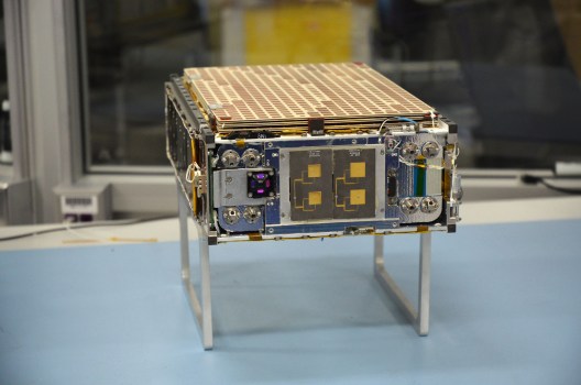

On average, Mars is about 225,000,000 kilometers away from earth. The communication link JPL is building between the two is the size of a shoebox. A 6U CubeSat measures about 10x20x30 cm. This is an incredible engineering challenge. The satellites need to be self sufficient, able to orient themselves correctly, be able to survive the trip from one planet to another, and have the radio equipment necessary to communicate over that distance. This is where the team Nacer works with comes into the picture.
Antenna engineers and mechanical engineers work together with the rest of the CubeSat teams to design and build the communications array. In this case, a brand new radio called IRIS was developed to help meet the power and size constraints. There almost no room inside the vehicle left for an antenna array so the reflectors were built to fold flat on the outside of the vehicle. The UHF antenna, which communicates with the Mars ground vehicles, sits flat on the bottom of the satellite but pops out like a jack-in-the-box.
The X-band antenna that transmits back to earth folds into three panels. When deployed, the reflector array is wider than it is tall so the signal source also has an array to utilize the full reflector. Interestingly, the pattern you can see on the reflector array helps the flat panels act more like a parabolic reflector. MarCO is also capable of receiving X-band from Earth using the array seen on the front face of the folded model above. These CubeSats are unable to transmit on the UHF band, they only receive the UHF communications from ground vehicles.

I don’t know if the video got to this, I just skipped through and couldn’t find an explanation of the mechanism by which the flat reflector works like a parabolic reflector.
After a bit of research it turns out that’s what’s called a shaped reflectarray. Basically an 2 surface of antenna structures without feeds for your target frequency. In this imeplementation they use a patch antenna for the resonant elements. By changing the size of the patch antenna to a bit above or a bit below it’s proper size at the target frequency the time it takes for reflection changes slightly. This causes the phase of the reflected radio wave to be controllable based on the size and placement of the patch antenna resonator elements. So they arrange them to match what the phase would be in a 2D slice of the beam output in front of a dish antenna. Because of this the reflection from the reflectarray has a pattern that acts like a dish antenna at that exact frequency. Here’s an plot from “Reflectarray Antennas: Analysis, Design, Fabrication, and Measurement” showing the sigmoid response curve of patch size vs phase shift: http://superkuh.com/patch-reflectarray-reflected-phase-shift-vs-patch-side-length.png
Pretty cool stuff. It has a much better aperture efficiency then flat refracting lenses like zone plates. But on the downside there are significant dielectric losses from the patch resonators on the dielectric. If they didn’t use dielectric then they patch elements would need to be much larger.
typo fix: Basically a *2D* surface of antenna structures without feeds for your target frequency.
This is exactly the comment I was looking for. I thought the antenna was super interesting, and it seems do behave in the way I expected it to. Really cool!
Thanks for checking into that. The Fresnel look of the patches implied a phase shift and I thought it might have something to do with the thickness of the PCB. Pretty dang interesting!

Does anyone know where to find papers on that specific type of reflectarray they are using? I’ve never seen that fresnel lens like pattern created by varying the size of the microstrip patches. Sooooo pretty!!!
Reflectarray: http://ieeexplore.ieee.org/stamp/stamp.jsp?tp=&arnumber=7859458
