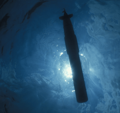

The back story is a little more reputable. I recently attended the Center for Marine Robotics meeting at the Woods Hole Oceanographic Institution (WHOI) and learned about a very interesting robot. For the Discovery Channel’s Shark Week the network partnered with [Amy Kukulya] at WHOI to develop an autonomous underwater vehicle (AUV) that locates, follows, and films sharks in their natural habitats, swimming, patrolling, doing their thing.
The AUV platform is called REMUS and it was extensively modified for the job. The shark gets tagged with an acoustic beacon. An acoustic homing array on the front of the robot follows the beacon. Additional systems on board keep the robot straight, level, and perform navigation tasks. Numerous GoPros are mounted for filming. The REMUS AUV cruises with the sharks for many miles and long durations. During this time it sends back meta data, location, speed, orientation, and any faults.
One day while operating in Guadalupe Island a very strange fault occurred. The vehicle suddenly found itself in a strange attitude, unexpected velocity vector, then it had a water alarm. Communications stopped on its way to the surface but it came up anyway. When the crew pulled it from the water they noticed huge gouges in its paint. The GoPro footage revealed what had happened….
A shark attacked the robot.
These sharks in particular were feeding on seals. It seems that the shark was below the robot and confused its silhouette for a seal. The shark attacked by swimming up at the robot from deep water.
In the video you can actually hear the shark’s teeth crunching up against the aluminum hull of the AUV. And there is more shark vs. robot footage showing different angles of attack.
