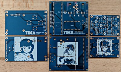

Being new to hardware, [Thea’s] initial goal was to simply get the YM2612 making noise. Songs from the Genesis can be stored in VGM format, which consists of the raw data fed to the sound chip required to reproduce the music. By feeding this data directly into the relevant registers of the YM2612 from a microcontroller, it was possible to create a jukebox for playing back Genesis chipmusic.
Designing your own PCBs means you get to decide on the graphics, and it’s clear Thea had fun with the process.
The hardware was now producing sound, but noise was an issue. Initial attempts to solve this with a MegaAmp circuit helped, but only slightly. [Thea’s] research indicated that the breadboard was a likely noise source, as well as the various switching regulators and buck converters in the microcontroller and display hardware. Designing all these out would be a major undertaking, so instead, [Thea] went a different route. The hardware got its very own PCB design, with separate analog and digital power supplies. With the noise issue solved, [Thea] set out to turn the rig into a real bonafide synth. The goal was to have hardware that could receive MIDI signals and play the appropriate sounds on the YM2612. Despite the early successes of the project, getting to the next stage proved to be an uphill struggle.
The final build looks resplendent in a tidy acrylic case with bright blue PCBs.
Much work then went into understanding how to interface properly with the YM2612. Sadly, documentation for the device is not publicly available. Contacting Yamaha directly turned up nothing, and researching emulators was somewhat of a dead end. Undeterred, [Thea] set out to analyse documentation from related hardware, enlisting the help of friends to decode the Japanese-only documents. There was also plenty of trial and error involved, such as manually jogging the write sequence timing until things started to work. Once the chip was understood, there was the final slog of making it into a properly useful synthesizer. Things like patch management, polyphony and unison settings, and parameter control all had to be dealt with.
Through perseverance, hard work, and solid research, [Thea] managed to come out on top. The completed Genesynth is capable of punching out fat FM synth lines with the best of them, ably demonstrated by [Thea] at the end of the talk with a fan-favorite track. It’s a project that shows what dogged persistence can achieve, and just how much you can learn along the way. For those eager to dig into the technical details, head to the Github, and if you’re working on your own epic synth project, be sure to tell us the tale!
