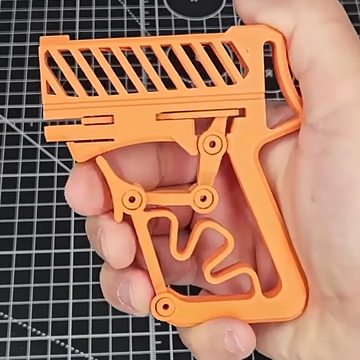

[It’s on my MIND] designed a clever BB blaster featuring a four-bar linkage that prints in a single piece and requires no additional hardware. The interesting part is how it turns a trigger pull into launching a 6 mm plastic BB. There is a spring, but it only acts as a trigger return and plays no part in launching the projectile. So how does it work?
There’s a spring in this BB launcher, but it’s not used like you might expect.
The usual way something like this functions is with the trigger pulling back a striker of some kind, and putting it under tension in the process (usually with the help of a spring) then releasing it. As the striker flies forward, it smacks into a BB and launches it. We’ve seen print-in-place shooters that work this way, but that is not what is happening here.
With [It’s on my MIND]’s BB launcher, the trigger is a four-bar linkage that transforms a rearward pull of the trigger into a forward push of the striker against a BB that is gravity fed from a hopper. The tension comes from the BB’s forward motion being arrested by a physical detent as the striker pushes from behind. Once that tension passes a threshold, the BB pops past the detent and goes flying. Thanks to the mechanical advantage of the four-bar linkage, the trigger finger doesn’t need to do much work. The spring? It’s just there to reset the trigger by pushing it forward again after firing.

  2. “Thanks to the mechanical advantage of the four-bar linkage, the trigger finger doesn’t need to do much work.”
    I’m not a physicist or mechanical engineer but please explain to me why this isn’t exactly the same amount of work as the trigger compressing a spring if you use the same sort of linkage in the other direction on a spring?
    Also, presumably overcoming the detente robs the bb of some of the compression energy (potential energy?) so it’s even less efficient than spring compression.
    Again, not a physicist or mechanical engineer but this “easier” “less work” assertion seems suspect.
    1. “the trigger finger doesn’t need to do much work”
      It should say that the trigger finger exerts less force. It does so over a greater distance. Work is force times distance.
      “The tension comes from the BB’s forward motion being arrested by a physical detente [sic]”
      That’s compression, not tension.
    2. That’s just a bit of imprecise/non-literal terminology. This sentence is just a quick, surface-level description and not meant to be read like a physics paper ;)
      It needs less force (because of the leverage), which means it feels easier to push and thus feels like less work for a human operator. You obviously still need to provide the same amount of energy for the same result as with another mechanism.
    3. The real problem is I don’t think this linkage is doing more work than a simple lever. Although there may be room for moving the “middle” link and thus increasing the mechanical advantage.
      As it is the pin is right behind where you put your finger on the trigger, so no mechanical advantage from the “front” lever.
      This leaves the rear lever as the only one creating increased leverage. Moving the middle link down would make the front lever actually do something, and could increase the effectiveness of the rear lever, as it is now longer and affords more choices of ratio.
      As it is now it is an excellent starting point, with no mechanical advantage over having a sliding trigger acting directly on the rear lever.
      Also the hopper needs some help, it isn’t really feeding right now (could be the slope of the feed trough, or some trimming needed to the 3D print.)
