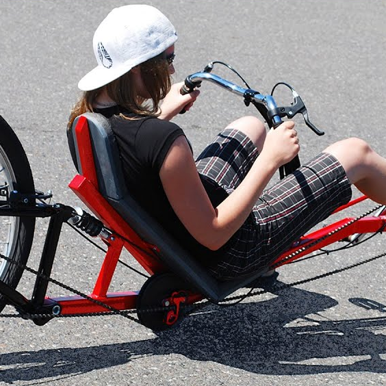

Thanks to [Radical Brad] for writing in to let us know about his recent project, building a street racing bike from square tubing and old bike parts.
In this 50 minute video [Radical Brad] takes us through the process of building the Marauder v2, a street racing LowRacer. The entire build was done over a few weekends using only an AC welder, angle grinder, and basic hand tools you probably have in the garage.
The entire rear section of the Marauder is made from an unmodified stock rear triangle from a typical suspension mountain bike. The frame is made from 1.5″ mild steel square tubing with 1/16″ wall thickness, which is called “16 gauge tubing”.
[Radical Brad] runs you through the process of welding the pieces together at the appropriate angles along with some tips about how to clamp everything in place while you work on it. After completing the rear end he proceeds to the front end which uses the fork from the front of the old bike. A temporary seat is fashioned from some wooden boards joined together with hinges. Then the steering system is installed. Then the chains and pulleys for the motion system. Then the seat is finalized, and after a coat of paint, and installing some brakes, we’re done!

I have ridden and built recumbent bikes and have a few observations.
I never understood the idea of putting a steering tube between your legs. There are two problems with it. First, you have to hold your hands up there, which pretty quickly gets tiring. Second, and more importantly, if you crash the bike, that tube is going to end up in the place you want it the least. Steering under the seat is much more comfortable (but I get it- this bike wasn’t made for comfort, mostly “cool”), as your hands just fall onto the handlebars.
The super long wheelbase is going to make for wobbly steering at low speeds, especially going up hill. The problem is the steering feels “delayed”. You turn the handlebars and it takes a while for the bike to respond, so you turn further. The bike catches up with your steering input and now you have to turn the other way because you turned too far. It makes for a wobbly ride at low speeds.
The super long chain is going to try to jump off the chainrings if you pedal while turning the bike at moderate speed. The mass of the chain wants to keep going forward in a straight line and you’re steering the bike away from that line. It’s better to keep chains shorter – break the chain up and put in a mid-drive gear.

I’d not object to the steering location myself, if you crash the bike you already screwed up and are probably going to be injured at least with minor bruising etc no matter where the steering is. And with under seat steering you can’t use your arms to resist going forwards over the top or into the handlebars nearly as much, and as with all recumbents you can’t just stand up and step off the bike as it goes wrong or roll off the bike etc – they are just not as easy to cushion your impact with the ground because of the body position (though with really low recumbents like this one the converse is you also don’t fall very far either).
Not ridden one like this, but I can’t see how this would get uncomfortable or really be tiring – its barely raising your arms at all! I’d also suggest it is a more versatile position as anybody can sit that little bit more upright, pad with an extra cushion or raise/lower the handlebars to put them in a comfortable enough location to give this bike a go. Where under your legs doesn’t have that same easy flexibility and I’m not entirely sure everyone would even be able to reach – some folks have long torsos compared to their arm length, and others arms so long the position you have placed yours would be uncomfortable most likely..
I suspect that ‘wobbly steering’ wouldn’t really be an issue either – just got to learn how that bike behaves and retrain your expectations.
I do however mostly agree with you, and like the design you went with. I especially agree on this thing being impossible to use safely on public roads. If you are going to have a lower more aerodynamic pedal powered object on the roads it probably needs to be a velomobile style as they usually have a taller fin on the body work with some lights etc to really be visible.
