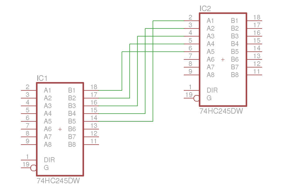

  10. Whatever your intentions are, it should start with correct connections at all. In the example on top of the article, tx and rx are never ever connected to the same name. Maybe the names of “tx=transmitting and rx=receiving” was not clear enough?
    1. heh if the left hand and right hand blocks are both ICs then yeah you’d usually want RX connected to TX? but if the left hand one is an IC and the right hand one is like a 4-pin header…
