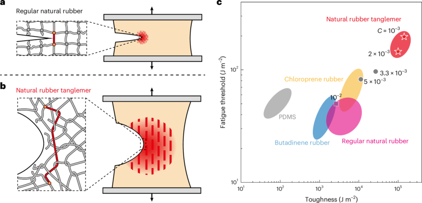

Note the differences between a short-chain crosslinked structure, and the longer-chain tanglemer structure with far less crosslinks. The latter is far better at resisting crack formation, since the longer chain can deconcentrate stress over a longer distance, allowing far greater stretch before failure. Credit: research paper

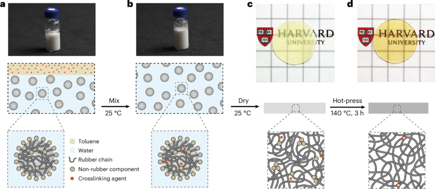

Harvard researchers modified the traditional rubber production process to be gentler. Typical rubber production includes heavy-handed mixing and extruding steps which tend to “masticate” the polymers in the material, turning them into shorter chains. The new, gentler process better preserves the long polymer chains initially present in the raw rubber. When put through the final stages of processing, these longer chains form into a structure referred to as a “tanglemer”, where the tangles of long polymer chains actually outnumber the sparse number of crosslinks between the chains in the structure.
The gentler production method involves drying the latex and additive mixture at room temperature to form a film, before hot-pressing it to form the final tanglemer structure. This process isn’t practical for producing large, thick parts. Credit: research paper
This tanglemer structure is much better at resisting crack formation. “At a crack tip in the tanglemer, stress deconcentrates over a long polymer strand between neighbouring crosslinks,” notes the research paper. “The entanglements function as slip links and do not impede stress deconcentration, thus decoupling modulus and fatigue threshold.” Plus, these long, tangled polymer chains are just generally better at spreading out stress in the material than the shorter crosslinked chains found in traditional vulcanized rubber. With the stress more evenly distributed, the rubber is less likely to crack or fail in any given location. The material is thus far tougher, more durable, and more flexible. These properties hold up even over repeated loading cycles.
Overall, the researchers found the material to be four times better at resisting crack growth during repeated stretch cycles. It also proved to be ten times tougher than traditional rubber. However, the new gentler processing method is fussy, and cannot outperform traditional rubber processing in all regards.  After all, there’s a reason things are done the way they are in industry. Most notably, it relies on a lot of water evaporation, and it’s not currently viable for thick-wall parts like tires, for example. For thinner rubber parts, though, the mechanical advantages are all there—and this method could prove useful.
