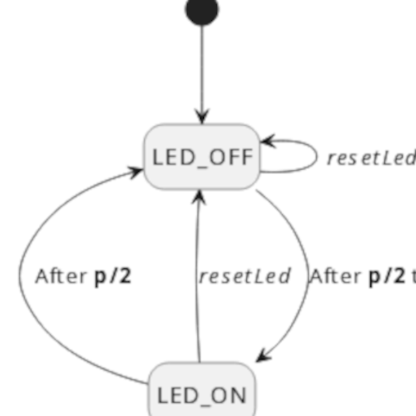

Once you dig in, though, you’ll see the system relies on state machines. Just to prove the point, he writes a basic implementation, which is fine, but hard to parse and modify. Then he shows a simple implementation using FreeRTOS, which is fine except for, you know, needing FreeRTOS.
Using a simple set of macros, it is possible to get something very similar to the RTOS version that runs independently, like the original version. Most of the long code snippets show you what code the macros generate. The real code is short and to the point.

I have a big dislike for macro’s and for “clever tricks”, but I do like C++. In his example of a blinking led. I would write a little class that has:
1). Function pointer.
2). Two functions: led_on() and led_off().
And then put a simple while() loop in main(), that repeatedly calls the function to which the function pointer points. You do have to think a bit of how you structure the functions of your state machine, but that is a good thing, because it forces you to think about program structure. State machines based on a function pointer also have very little overhead, and it’s easy to see the overall structure of the program in the while() loop in main(). It’s also completely free of macro trickery.

As a bare metal embedded developer in C, I came to regard the main process loop (an infinite for loop) as being analogous to an operating system of sorts. This only contains calls to the various process handler functions that the system needs to carry out all of its tasks. There is no preemption (apart from a few ISRs). The trick is, to write all of the process handlers, as well as their helper functions, to only do work on what’s immediately available, and return as soon as there’s nothing to do. They should never wait for anything.
Writing code this way, is dependent on writing efficient state machines, never using wait functions, but instead relying on timers that can be started, and then testing for completion elsewhere within the state machine typically several process loop iterations later. However, coding this way can be quite challenging for some programmers…
