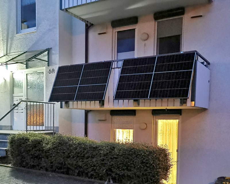

Balcony solar does have some limitations compared to rooftop installs. Often, installation angles are imperfect for making the most of the sun available. There are also limitations to how much power you can get out of such a system. Germany’s initial regulations for “balkonkraftwerk” systems stated that feed in power had to be limited to 600 watts to avoid potential issues with household wiring and sockets that were never designed for feed-in solar power.
Updated regulations allow up to 800 watts of feed-in, with an additional regulation that the installed panels do not exceed a level of 2000 watts peak output. It might sound like a mismatch, but it’s possible to use the excess power from the panels to charge a battery when the output exceeds the 800-watt limit. Having larger panels with higher peak output is useful, too, for when the sun isn’t shining so bright. A 2000 watt peak panel setup will be outputting 800 watts or more far more often than a set of panels that only delivers 800 watts in peak conditions.
The panels are generally installed in ad-hoc fashion. Credit: Nikolai Twin, CC BY 4.0
