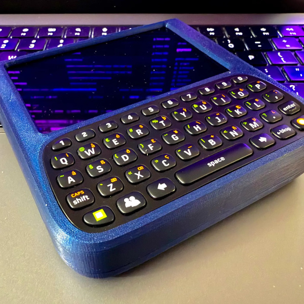

As single board computers have become ever smaller and more powerful, so have those experimenting with them tried to push the boundaries of the machines they can be used in. First we had cyberdecks, and now we have handheld terminals. Of this latter class we have a particularly nice example from [Random Alley Cat]. It takes a Raspberry Pi Zero 2W and a handful of other parts, and makes them with a 3D printed case into something very professional indeed.
One of the problems with these designs has always been tidily packing away all the parts with their cables, and it’s one she solves by making a chassis to hold all the parts, and a case which fits around that. In a stroke the case no longer has to provide a dual function, allowing for a much easier internal layout. Her screen is a Pimoroni Hyperpixel, the keyboard is an Xbox 360 accessory, and the power supply is an off the shelf Pi UPS board and battery.
We particularly like the accesses on the underside of this machine to access the Pi ports, and the ventilation holes and external case details. It’s not perfect, as she says in the video below it’s not the best Linux keyboard. but we could really see ourselves using this.

Looks like a sensibly chunky level of external size to me – actually looks comfortable to operate because of it, and the screen seems like a huge step up from the old ones. As for battery life I expect this is better than any of the old ones are now, as it actually has a brand new battery.
Yes there is some obvious potential for a more refined version with extra tweaks to suit your desired use but as a simple to replicate project by design it really works for that, while also being a rather potent mini PC with a great deal of flexibility in what you can use it for those old devices just wouldn’t do at all..

I use it often to play around with terminal stuff and hardware bits I have lying around. I actually made it many months ago and finally decided to make a video. Also, my Youtube channel isn’t monetized and I don’t get paid anything for any of this. Whoever wrote this article is probably getting more for this than I ever will. Not everything has to be a business.
All of the parts will be cannibalized eventually because that’s kinda the point. I do have more than one chatpad though, and I definitely have way too many Pi Zeros. The next version will be CM4/CM5 and won’t use a single piece from this proof of concept.

Really nice idea, but it seriously needs more screws. Having to open up a case by sliding a sharp edge in to a line can be pretty furstrating, I’ve a few commercial items with snap-fit covers of this kind and getting in to them is horrible. Also, that kind of no-screws case is going to rely on the flexing of a piece of plastic somewhere in it, multiple snap-in-to-place tabs I’d guess, and these will eventually wear out. Also, it might fall open when you really don’t want it to. A screw going in to a hole, and a hexagonal sink to hold a nut at the other edge will never wear out, never fall open by accident, and the tool to open it, a screwdriver, is almost as widely available as a sharp edge, but much more straighforward to use. Yes, commercial designs like to use snap fits, because they are trying to shave fractions of a penny of a design, but screws are cheap, so we should hold ourselves to better standards than penny-pinching mass-production lines do.
heh it’s all a matter of perspective. my last few laptops snap together and screw, and i find that pretty usable and i haven’t broken the snap tabs in a long time. but the real test for me is phones…i’ve had enough phones that are just glue holding it together that the ones that are snap, or even snap+glue, are much preferred.
but all your points are right on — it’s definitely not as secure as screws….but fwiw (sorry to be contrary) screws and sinks do wear out and fall open by accident :( they’re much better than snaps but they’re far from immune to wear and failure
A plastic spring doesn’t have to be fatigued even by regular use – all about how it is designed and staying within that elastic limit, which I’d think this does very well. It also looked like there was an easy guide the tool in notch to help you get between the shell sides with the prying implement, so it is for a snap fit really quite friendly.
Also there are benefits to cases that can under duress detach before the plastic breaks – I’m thinking things like those Nokia Brick phones that you could drop from high enough it probably hits terminal velocity into concrete and nothing is harmed by that impact most of the time – the case has sprung off no doubt, but it didn’t actually break and absorbed some of that impact in the process…
Screws and bolts are still the preferred method for my own projects in general, I am just trying to point out the whole ” we should hold ourselves to better standards than penny-pinching mass-production lines do.” could easily include designing around plastic clips as they are not inherently wrong, and in this case it is darned close to if not as good as it can be with plastic clips, and really wouldn’t be made better for having screws for most users.
It’s just a prototype, and there is a slot to fit something in to pop it open, I just used a knife because it was right there. The pont of it is that the .step files are posted so that anyone can mod it to their own hardware and preferences, so if you like it other than the lack of screws, it should be an easy fix. If you don’t know CAD, this could be a good way to start learning.
