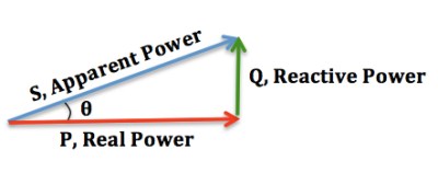

The power triangle, showing the relationship between real, apparent and reactive power. (Source: Wikimedia)
PF can be understood in terms of the two components that define AC power, being:
  • Apparent Power (S, in volt-amperes or VA) and
  • Real Power (P, in watts).
The PF is defined as the ratio of P to S (i.e. `PF = P / S). Reactive Power (Q, in var) is easily visualized as the angle theta (Θ) between P and S if we put them as respectively the leg and hypotenuse of a right triangle. Here Θ is the phase shift by which the current waveform lags the voltage. We can observe that as the phase shift increases, the apparent power increases along with reactive power. Rather than being consumed by the load, reactive power flows back to the generator, which hints at why it’s such a problematic phenomenon for grid-management.
From the above we can deduce that the PF is 1.0 if S and P are the same magnitude. Although P = I × V gets us the real power in watts, it is the apparent power that is being supplied by the generators on the grid, meaning that reactive power is effectively ‘wasted’ power. How concerning this is to you as a consumer mostly depends on whether you are being billed for watts or VAs consumed, but from a grid perspective this is the motivation behind power factor correction (PFC).
This is where capacitors are useful, as they can correct the low PF on inductive loads like electric motors, and vice versa with inductance on capacitive loads. As a rule of thumb, capacitors create reactive power, while inductors consume reactive power, meaning that for PFC the right capacitance or inductance has to be added to get the PF as close to 1.0 as possible. Since an inductor absorbs the excess (reactive) power and a capacitor supplies reactive power, if both are balanced 1:1, the PF would be 1.0.
In the case of modern switching-mode power supplies, automatic power factor correction (APFC) is applied, which switch in capacitance as needed by the current load. This is, in miniature, pretty much what the full-scale grid does throughout the network.

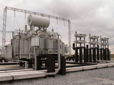

Magnetically controlled shunt reactor (MCSR). (Credit: Tayosun, Wikimedia)
Based on this essential knowledge, local electrical networks were expanded from a few streets to entire cities. From there it was only a matter of time before transmission lines turned many into few, with soon transmission networks spanning entire continents. Even so, the basic principles remain the same, and thus the methods available to manage a power grid.
Spinning generators provide the AC power, along with either the creation or absorption of reactive power on account of being inductors with their large wound coils, depending on their excitation level. Since transformers are passive devices, they will always absorb reactive power, while both overhead and underground transmission lines start off providing reactive power, overhead lines start absorbing reactive power if overloaded.
In order to keep reactive power in the grid to a healthy minimum, capacitive and inductive loads are switched in or out at locations like transmission lines and switchyards. The inductive loads often taken the form of shunt reactors – basically single winding transformers – and shunt capacitors, along with active devices like synchronous condensers that are effectively simplified synchronous generators. In locations like substations the use of tap changers enables fine-grained voltage control to ease the load on nearby transmission lines. Meanwhile the synchronous generators at thermal plants can be kept idle and online to provide significant reactive power absorption capacity when not used to actively generate power.
Regardless of the exact technologies employed, these traditional grids are characterized by significant amounts of reactive power creation and absorption capacity. As loads join or leave the grid every time that consumer devices are turned off and on, the grid manager (transmission system operator, or TSO) adjusts the state of these control methods. This keeps the grid frequency and voltage within their respective narrowly defined windows.
