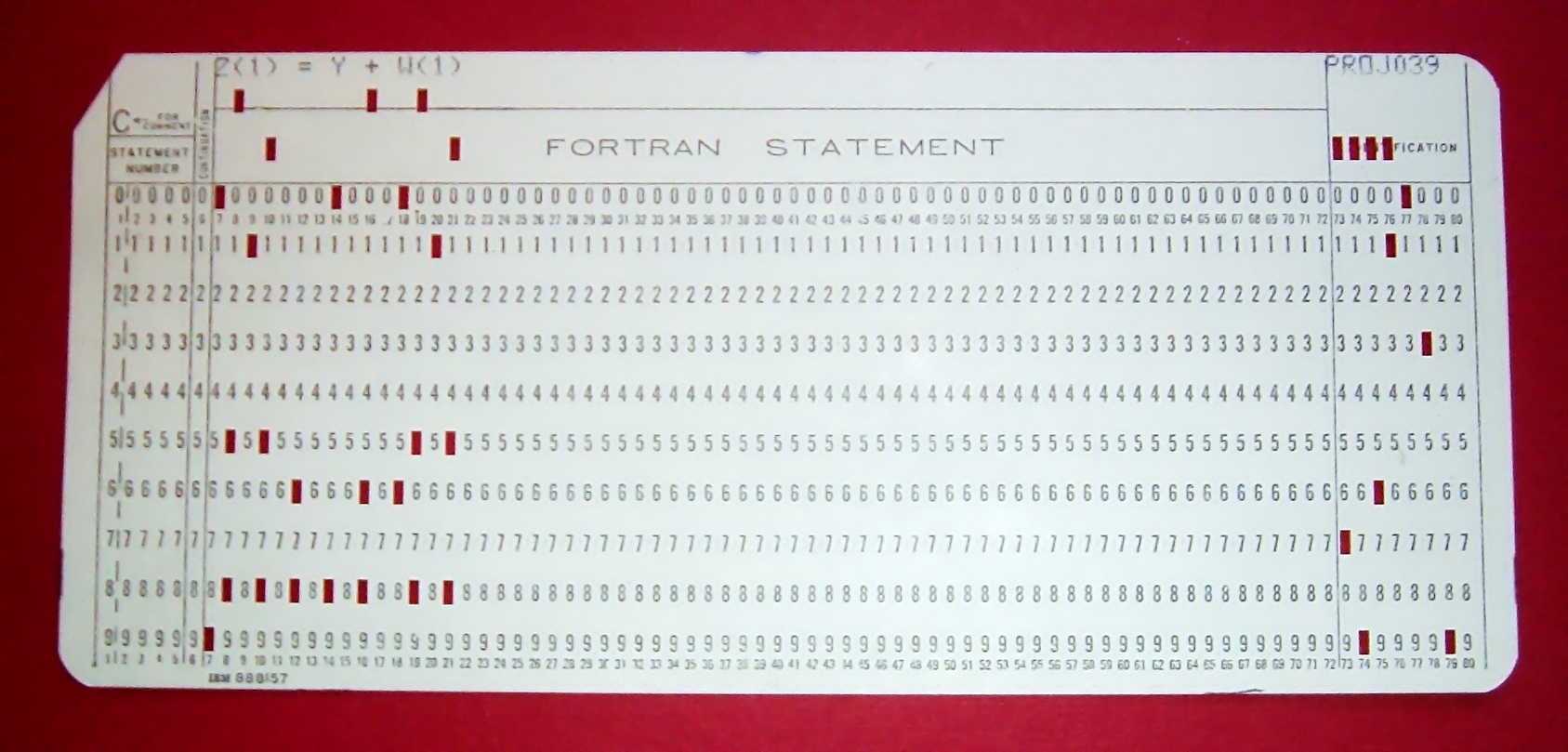

Punch card from a typical FORTRAN program by the early 1970s. (Credit: Arnold Reinhold, Wikimedia)
The release of the Fortran 90 (F90) specification in 1991 was the first major update to the language since Fortran 77, and introduced many usability improvements, as well as the dropping of punch card era legacy requirements and limitations to variable lengths and more. This is the reason for our focus on F90 here, as there is no real reason to use F77 or earlier, unless you’re maintaining a legacy codebase, or you have a stack of new cards that need punching. In case you are dying to know what changed, the Wikibooks Fortran Examples article has examples of early FORTRAN all the way to modern Fortran.

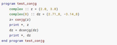

For example, conjugating a complex number with conjg:
Complex conjugation example in Fortran. (Credit: Fortran Wiki)
Basically, whatever mathematical operation you wish to perform, Fortran should have you covered, allowing you to translate your formulas into a functional program without having to bother with any dependencies or the like. This includes working with matrices and getting into the weeds with numerical precision.
