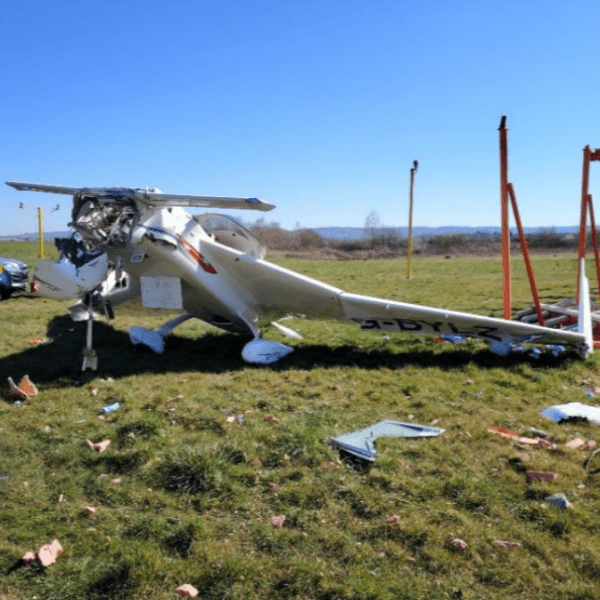

Back in March, a small aircraft in the UK lost engine power while coming in for a landing and crashed. The aircraft was a total loss, but thankfully, the pilot suffered only minor injuries. According to the recently released report by the Air Accidents Investigation Branch, we now know a failed 3D printed part is to blame.
The part in question is a plastic air induction elbow — a curved duct that forms part of the engine’s air intake system. The collapsed part you see in the image above had an air filter attached to its front (towards the left in the image), which had detached and fallen off. Heat from the engine caused the part to soften and collapse, which in turn greatly reduced intake airflow, and therefore available power.
Serious injury was avoided, but the aircraft was destroyed.
While the cause of the incident is evident enough, there are still some unknowns regarding the part itself. The fact that it was 3D printed isn’t an issue. Additive manufacturing is used effectively in the aviation industry all the time, and it seems the owner of the aircraft purchased the part at an airshow in the USA with no reason to believe anything was awry. So what happened?
The part in question is normally made from laminated fiberglass and epoxy, with a glass transition of 84° C. Glass transition is the temperature at which a material begins to soften, and is usually far below the material’s actual melting point.
When a part is heated at or beyond its glass transition, it doesn’t melt but is no longer “solid” in the normal sense, and may not even be able to support its own weight. It’s the reason some folks pack parts in powdered salt to support them before annealing.
The printed part the owner purchased and installed was understood to be made from CF-ABS, or ABS with carbon fiber. ABS has a glass transition of around 100° C, which should have been plenty for this application. However, the investigation tested two samples taken from the failed part and measured the glass temperature at 52.8°C and 54.0°C, respectively. That’s a far cry from what was expected, and led to part failure from the heat of the engine.
The actual composition of the part in question has not been confirmed, but it sure seems likely that whatever it was made from, it wasn’t ABS. The Light Aircraft Association (LAA) plans to circulate an alert to inspectors regarding 3D printed parts, and the possibility they aren’t made from what they claim to be.

    5. Ultimately it is the aircraft owners responsibility to ensure he is installing an airworthy part on his aircraft ! Period !
  2. That glass transition temperature indicates PLA, not ABS with its much higher temperature.

    “The aircraft owner who installed the modified fuel system stated that the 3D-printed induction elbow was purchased in the USA at an airshow, and he understood from the vendor that it was printed from CF-ABS (carbon fibre – acrylonitrile butadiene styrene) filament material, with a glass transition temperature3 of 105°C.”

    1. Report: “A review of the design of the laminated induction elbow in the Cozy Mk IV plans showed
      that it featured a section of thin-walled aluminium tube at the inlet end of the elbow, where
      the air filter is attached. The aluminium tube provides a degree of temperature-insensitive
      structural support for the inlet end of the elbow. The 3D-printed induction elbow on G-BYLZ
      did not include a similar section of aluminium tube at the inlet end.”
      So we have a different construction that does not match the idea behind the function of the laminated epoxy part.
