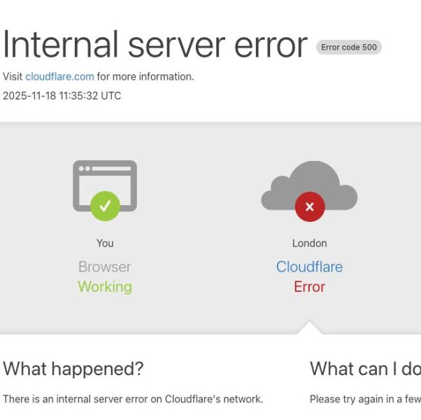

How One Uncaught Rust Exception Took Out Cloudflare
On November 18 of 2025 a large part of the Internet suddenly cried out and went silent, as Cloudflare’s infrastructure suffered the software equivalent of a cardiac arrest. After much panicked debugging and troubleshooting, engineers were able to coax things back to life again, setting the stage for the subsequent investigation. The results of said investigation show how a mangled input file caused an exception to be thrown in the Rust-based FL2 proxy which went uncaught, throwing up an HTTP 5xx error and thus for the proxy to stop proxying customer traffic. Customers who were on the old FL proxy did not see this error.
The input file in question was the features file that is generated dynamically depending on the customer’s settings related to e.g. bot traffic. A change here resulted in said feature file to contain duplicate rows, increasing the number of typical features from about 60 to over 200, which is a problem since the proxy pre-allocates memory to contain this feature data.
While in the FL proxy code this situation was apparently cleanly detected and handled, the new FL2 code happily chained the processing functions and ingested an error value that caused the exception. This cascaded unimpeded upwards until panic set in: thread fl2_worker_thread panicked: called Result::unwrap() on an Err value
The Rust code in question was the following:
The obvious problem here is that an error condition did not get handled, which is one of the most basic kind of errors. The other basic mistake seems to be that of input validation, as apparently the oversized feature file doesn’t cause an issue until it’s attempted to stuff it into the pre-allocated memory section.
As we have pointed out in the past, the biggest cause of CVEs and similar is input validation and error handling. Just because you’re writing in a shiny new language that never misses an opportunity to crow about how memory safe it is, doesn’t mean that you can skip due diligence on input validation, checking every return value and writing exception handlers for even the most unlikely of situations.
We hope that Cloudflare has rolled everyone back to the clearly bulletproof FL proxy and is having a deep rethink about doing a rewrite of code that clearly wasn’t broken.

      1. From the official Cloudflare debrief:
        “Customers on our old proxy engine, known as FL, did not see errors, but bot scores were not generated correctly, resulting in all traffic receiving a bot score of zero. Customers that had rules deployed to block bots would have seen large numbers of false positives.”
        So no, the C implementation did not detect it, it did not have a nice error to log. It kept churning through, spitting out bad scores, with no indication of a problem.
        Yes, the Rust version caused a very public issue. But to say the rewrite in a new language “backfired” is a bit narrow-sighted. The reason you’re claiming the old codebase is better is because the problems it caused happened in the past and have subsequently been fixed, and the problems from the new codebase are happening right now. Given the same time, the new codebase /will/ be just as robust as the old one, but will have the added benefit of using an updated architecture (see below), and a more modern language. The issue arose not because they used Rust, but because they are doing a rewrite. Had they done the rewrite of FL2 still in C, or chosen C++, or Go, or Malbolge, they would without a doubt have had similar problems, because it’s an untested codebase, and as one of the most central companies to the internet any problem is a big problem.
