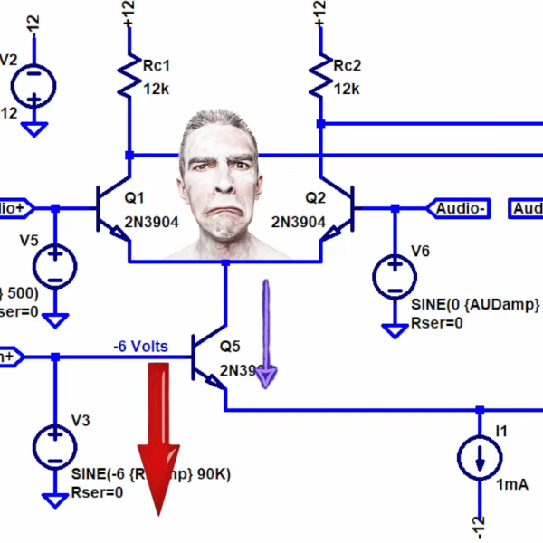

If you’ve ever used an NE602 or similar IC to build a radio, you might have noticed that the datasheet has a “gilbert cell” mixer. What is that? [Electronics for the Inquisitive Experimenter] explains them in a recent video. The gilbert cell is a multiplier, and multiplying two waveforms will work to mix them together.
At the heart of the gilbert cell is essentially three differential amplifiers that share a common current source. The video shows LTSpice simulations of the circuits as he explains them.
One reason these work well on ICs is that they require very closely-matched transistors. In real life, it is hard to get transistors that match exactly. But when they are all on the same slab of silicon, it is fairly straightforward.
What we really like is that after simulating and explaining the circuit, he explains why multipliers mix signals, then builds a real circuit on the bench using discrete transistors and matched transistor arrays. There is a bit of trigonometry in the explanation, but nothing too difficult.
Of course, the most common application of differential amplifiers is the op amp. The NE602 is out of production, sadly, but if you can find any, they make dandy receivers.

  5. The Vout vs Vrfin depicted at 10:13 (i.e. in VCA mode) looks like a non-linear relation. I wonder why that is, and is suggests there would be unwanted harmonics to filter out. Not as much with a diode mixer, but some nonetheless.
    1. You can linearize each differential pair by adding a small resistance in the emitter leads. I did this in my implementation of the Phase Locked Loop FM Stereo Demodulator (1970) to reduce phase jitter due to subharmonics of 19 kHz in the audio.
