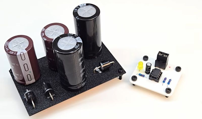

In a recent video [QWZ Labs] demonstrates an interesting technique to use 3D printing to make creating custom PCBs rather straightforward even if all you have is a 3D printer and a roll of copper tape.
The PCB itself is designed as usual in KiCad or equivalent EDA program, after which it is exported as a 3D model. This model is then loaded into a CAD program – here Autodesk Fusion – which is used to extrude the traces by 0.6 mm before passing the resulting model to the 3D printer’s slicer.
By extruding the traces, you can subsequently put copper tape onto the printed PCB and use a cutting tool of your choice to trace these raised lines. After removing the rest of the copper foil, you are left with copper traces that you can poke holes in for the components and subsequently solder onto.
As far as compromises go, these are obviously single-sided boards, but you could probably extend this technique to make double-sided ones if you’re feeling adventurous. In the EDA you want to use fairly thick, 2 mm trace width with plenty of clearance to make your copper cutting easy, while in the slicer you have to check that the traces get printed properly. Using the Arachne wall generator option for example helps to fill in unpleasant voids, and the through-holes ought to be about 1 mm at least lest the slicer decides that you really want to drill them out later by hand instead.
While soldering is pretty easy on copper tape like this, desoldering would be more challenging, especially with hot air. In the video PLA was used for the PCB, which of course is rather flexible and both softens and melts easily when exposed to heat, neither of which make it look very good compared to FR4 or even FR1 PCB materials. Of course, you are free to experiment with whatever FDM, SLA or even SLS materials you fancy that would work better for the board in question.
Although obviously not a one-size-fits-all solution for custom PCBs, it definitely looks a lot easier than suffering through the much-maligned prototype perfboards that do not fit half the components and make routing traces hell. Now all we need is the ability to use e.g. targeted vapor-deposition of copper to make fully 3D printed PCBs and this method becomes even easier.

In the top photo on the left I see a power supply where I assumed 1/4inch wide tape would be all that’s needed. No conductive paint would work here for sure. I like the comment about negative space depth ‘traces” but at a DIP spacing that’s a mess.

You might also print a sort of solder stencil-like part that would press in and create a level looking surface after it was installed.
Might not be that practical (yet) but who knows where it may lead.
3D print solder paste? 🤔
Another comment suggested recessed traces to clean the rest by sanding, and with your suggestion that would work well
I like it sometimes you want a beautiful product without having to ship it off to a board manufacturer especially in the age of tariffs
Yes. Whatever are our opinions on the technicalities: it does look good. Beauty is in the eye of the beholder, and I think it could have been done a bit more artistically, given the amount of possibilities that the technique gives, but it does look good. :)
Just use conductive filament to make the traces. Then you can have as many trace layers in the board (ie: 3d object) as you want…
Is anyone here old enough to remember the days when pc boards were made with dry transfer film and resist tape?
It’s what this method reminded me of.
Yep. Never used it personally, but my dad did it professionally for prototyping purposes.
Or actually, probably he didn’t do full designs, but partial rework if a prototype had an issue.
I just buy 100pcs of these: https://hadex.cz/s006-cuprextit-50x60x15mm-cu35um-material-fr-4/
Costs roughly €10 for the whole bag. Then I cut copper tape as thin as required and simply apply it as needed. Then I solder the corners to make sure it’s connected. Since the board doesn’t flex and has a good ground plane on the other side, you get decent impedance control as a bonus.
When I need to connect MCU, e.g. RPi Pico, the easiest way is female header glued to the board lying on one side. Then run traces to the pins, bend them down as needed and solder them to the traces. It’s a good idea to run GND tape under the header and solder it to the ground plane. You can also trivially add SMA connectors. And since the board is rigid, you don’t have to worry when you fasten them.
I usually prep the board with 20P connector for a Pico project in 10 minutes tops. Then build the circuit on the board. I don’t use THT components at all, everything is SMD. I prefer 1206 capacitors and 0805 resistors, inductors. 0805 capacitors are too fragile. I have purchased rolls of 1000pcs resistors from 10Ω to 10MΩ in multiples of 10, plus some other values I tend to use, costs very little. Capacitors and inductors are more costly, but still manageable to buy in 50-200pcs quantities if you are a bit tactical about it.
For ICs, it’s obviously the larger the (leaded) package, the better. But when you flip it and secure with hot glue, even very low pitch parts are doable, it just costs a lot more time.
Lately I’ve been thinking about having boards with holes for the header and various IC pads premade. But the price deters me a bit.
I want to see a multilayer version! It might even be able to neatly recess the traces of the internal layer into the next layers backside!
Do the traces lowered instead. Then you can sand off the parts that shouldn’t conduct.
I don’t think that would sand nicely, I would rip and peel unpredictability
Depends on your tools. When everybody had a CNC mill, it was easier to etch the traces. Now everybody has a 3D printer, so……
I would think that the mill would be faster, though, and less fuss – using basically the same machine instructions, though subtractive, not additive.

I guess the plastic melting around the heated pins is good to keep them in place, otherwise the thin copper foil would get pushed and ripped easily
Don’t want to be the complaining guy, but… why, really? When I was a kid I always wanted to have a CNC to make PCBs at home…
But nowadays nothing you could make yourself will get close to the $2 boards (with 4-layers!) you get from China. Yes, the shipping is slow, but is it a problem at all? If you have a full time job and this is a hobby, you can still work on the details and firmware on a breadboard while waiting for the first prototype. And then subsequent prototype iterations are even easier – just rework your previous prototype with kynar wire and move onto the clean next one when it arrives.
What if you printed the traces a little higher than that yet? And then you also printed a negative version.
Now it’s a stamp. Apply your copper tape. Squeeze it into the negative. Hopefully it cuts the copper at the edges of the traces and pushes the unwanted copper down into the valleys breaking contact with the traces.
Then just hope you can pull the pieces back apart! It might take some tweaking with ever-so slightly over-sizeing the traces on the negative so that you can pull it apart easily while still being tight enough to cut the copper tape.
Seems to me it would be easier to just use a Cricut to cut out the copper tape and apply it with transfer tape to the board.
I’m an EE and I have to say I think this is a great idea. 1. It lets you design the layout in CAD, which is easier than doing it on paper or manually transcribing from CAD. 2. The raised tracks make it easy to trace with a blade quick and clean. For 0.1in pitch designs it seems like a great method.
Most makers today have a 3D printer at the ready so it seems like a highly convenient option to me.

IMao, what this is really missing is an automated process to cut the foil, doing that by hand isn’t great, I have tried it before and so have many others. There is a reason people have been looking for usable conductive printing materials. Have you tried inverting the circuit? Maybe then leather cutting tools could make this a bit more reasonable.
In the end it’s a useful technique so I don’t want to discount your efforts, but actual applicability is going to vary greatly.
Why not try hp copper filament and inlaying the copper.. would be able to just peel away the excess tape, and have the copper have some heat transfering property. Also by removing the poorly adhered top layer you could potentially just expose the copper traces :).. that’s what I would have tried =]

I thought of something similar when I bought my first 3d printer back 2016. It quickly evolved into making the “traces” trenches I cut lay wire into instead of tape and using a wire wrap tool. But once you reach that point, you might as well by nonconductive perf board and either solder or wire wrap.
Has nobody commented on the implications that any kind of heat will melt this plastic and turn the project into unusable goo?
Print in anything but the really low temp softening PLA family and it will be very little if any different in practice to the FR4 board based circuit in regard to temperature failure, even if the method of failure is different as the vast majority will be component failure through overheating long before substrate notices.

I already tried using copper tape to build small pads to solder Manhattan style, the adhesive doesn’t stand the solder heat and they detach easily. It can work with a large ground screen with one solder joint, but slim traces or small pads are different things.
