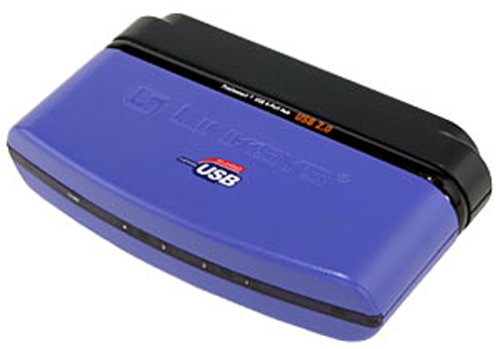

Can you do a Howto on adding software control to the USB powered Woot-Off lights before the next Wootoff?? :)
@another-anonymous: I’ve always thought that would be a kickass idea; sometimes I’m not at my computer when an IM comes in. The woot-off lights, or an ambient orb, or something similar could be set to go off at certain events.
Two of my favorite websites coming together… I’m so happy! I just might cry…
My Rovio arrived today. So far I’m a bit disappointed as I seem to have received one that has battery or charger issues.
@another-anonymous: To control the woot-off lights from software all you need is a per port powered usb hub. This will allow you to shut off/on the power of each port.
Here is one with Per port power:
http://www.amazon.com/Cisco-Linksys-USB2HUB4-USB-4-Port-Hub/dp/B00007AKAZ
Then you just need a program call hub-ctrl from here
http://www.gniibe.org/ac-power-by-usb/ac-power-control.html
Write a little script and there you go!
