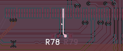

I went and changed all 0.4 mm / 0.2 mm vias to 0.4 mm / 0.3mm vias, and that went surprisingly well – no extra DRC errors. The hole-to-copper distance is set to be pretty low in this project, to 0.15 mm, because that’s inherited from LattePanda carrier files, so I do hope that JLC doesn’t balk at those vias during the pre-production review. Speaking of DRC, I also set all courtyard errors to “ignore” – not only does this category have low signal-to-noise ratio, the LattePanda module courtyard also would raise problems at all items placed under the module, even though there’s plenty of space as long as you use a DDR socket tall enough.

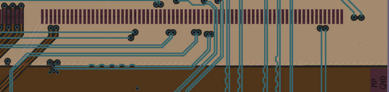

One thing looked somewhat critical to me, though – the VDC polygon, specifically, the way it deprived quite a few diffpairs from GND under them.
Redraw, Nudge, Compromise

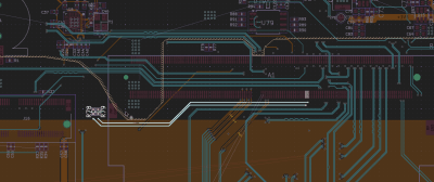

Remember, you want a ground polygon all along the underside of the differential pair, from start to finish, without interruptions – that ground polygon is where ground return current flows, and it’s also crucial in reaching the right differential pair impedance. The VDC polygon did interrupt a good few pairs, however.

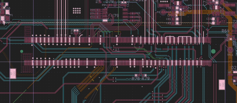

Most of those interruptions were fixed easily by lifting the VDC polygon. Highlighting the net (` keyboard key) showed that there’s only really 4 consumers of the VDC power input, and all of them were above the overwhelming majority of the diffpairs. REFCLKs for M.2 sockets had to be rerouted to go over ground all throughout, though, and I also added a VDC cutout to pull gigabit Ethernet IC PCIe RX/TX pairs over VDC for most of their length.
This polygon carries a fair bit of current, a whole N100 (x86) CPU’s worth and then some, and remember – inner layers are half as thick, only 0. 5oz instead of 1 oz you get for outer layers by default. So, while we can cut into it, the VDC path has to be clear enough. A lot of items on VDC, like some gigabit controller power lines, ended up being moved from the VDC polygon layer to the opposite inner layer – now, they’re technically on the layer under PCIe and gigabit Ethernet pairs, but it’s a better option than compromising VDC power delivery. I also moved some VDC layer tracks to B.Cu and F.Cu; remember, with high-speed stuff you really want to minimize the number of inner layer tracks.

With the vias changed and polygon redrawn, only a few changes remained. Not all diffpair layer crossings had enough vias next to them, and not all GND pads had vias either – particularly on the Mu and M.2 slots, what’s with high-speed communications and all, you have to make sure that all GND pads have GND vias on them. Again, highlight GND net (`) and go hunting. Afterwards, check whether you broke any polygons on inner layers – I sure did accidentally make a narrow passage on VDC even more narrow with my vias, but it didn’t take much to fix. Remember, it’s rare that extra vias cost you extra, so going wild on them is generally safe.
