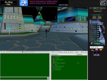

Inspired By Wheels
View of CyberTown's VRML-based Plaza and interface.
View of CyberTown’s VRML-based Plaza and interface.
With an internet-based virtual reality a highly topic concept, David Raggett from Hewlett Packard Laboratories submitted a paper back in 1994 titled Extending WWW to support Platform Independent Virtual Reality. This imagined a virtual reality layer to the WWW by the end of the millennium featuring head-mounted displays (HMDs) and tracking of a user’s limbs to fully integrate them into this virtual world with potentially realistic physics, sound, etc.
Describing these virtual worlds would be at the core of this VR push, with SGML (standardized general markup language) forming the basis of such world definitions, much like how HTML is a specialized form of SGML to define the structure and layout of a document. The newly minted VRML would thus merely define 3D worlds rather than 2D documents, with both defining elements and their positioning.
Although nothing revolutionary by itself – with games and 3D modeling software by then having done something similar with their own file formats to define 3D models and worlds for years already – VRML would provide a cross-platform, fully open and independent format that was specifically made for the purpose of this online VR experience.
All Starts With Polygons
The interesting thing about VRML is perhaps that it was pushing for a shared online 3D experience years before the first commercially successful MMORPG came onto the scene in 1999 in the form of EverCra^WEverQuest. VRML was pitched in 1994 and by 1995 the very RPG-like MMO experience called Colony City (later CyberTown) was launched. This created a virtual world in which members could hold jobs, earn virtual currency and purchase 3D homes and items that were all defined in VRML.
CyberTown endured until 2012 when the company behind it shut down, but there’s an ongoing push to revive CyberTown, with the revival project‘s GitHub project giving a glimpse at the preserved VRML-based worlds such as the home world. These .wrl files (short for ‘world’) use the VRML version 2.0 standard, which was the 1997 version of VRML that got turned into an ISO standard as ISO/IEC 14772:1997, with the specification itself being readily available over at the Web3D website.
