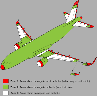

Certain areas of the plane are more likely to suffer damage from a lightning strike—most damage occurs where the lightning strike enters or leaves the aircraft body. Credit: Airbus

    1. But there is a legend! The text happens to be black, while the background is almost black. It says:
      Zone 1: Areas where damage is most probable (initial entry or exit points)
      Zone 2: Areas where damage is probable (swept strokes)
      Zone 3: Areas where damage is less probable
