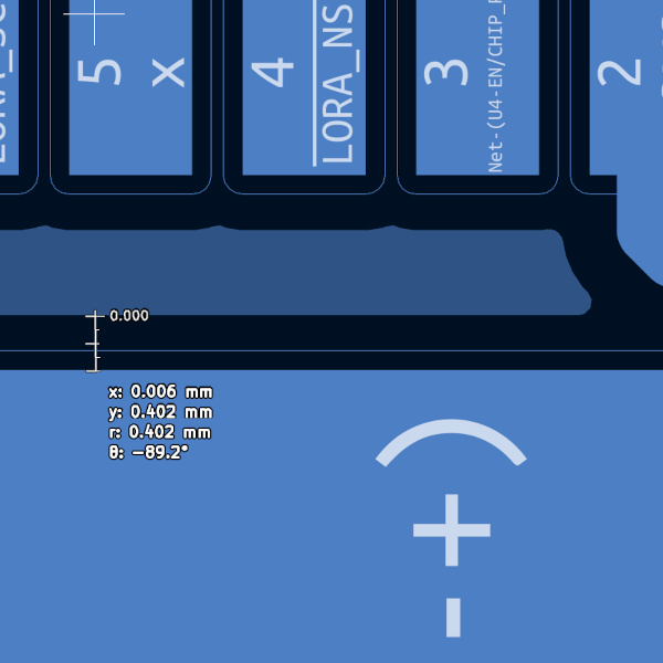

The concerns were raised from the RevSpace hackerspace in Leidschendam, and centre around the design of the battery power traces on the PCB between the battery holders and the power supply circuitry. Because the 18650 cells supplied with that badge lack any protection circuitry, bridging the power traces could be a fire risk.
In short: their report names the cell holders as having tags too large for their pads on the PCB, a too-tight gap between positive and negative battery traces, protected only by soldermask, and the inadequacy of the badge’s short circuit protection. In the event that metal shorted these battery tags, or wore through the soldermask, the batteries would be effectively shorted, and traces or components could get dangerously hot.
The WHY organizers have responded with a printed disclaimer leaflet warning against misuse of the cells, and added a last-minute epoxy coating to the boards to offer additional protection. Some people are 3D-printing cases, which should also help reduce the risk of short-circuiting due to foreign metal objects. Using an external powerbank with short-circuit protection instead of the cells would solve the problem as well. Meanwhile a group of hackers collecting aid for Ukraine are accepting the batteries as donations.

    Hi, I am the author of the analysis document and part of the group of people who found and reported the issues. I am neither part of Badge.Team (the team that left) nor Team:Badge (the current team). I am, however, part of the “orga” of the event itself.
    In fact, I carefully avoided contacting anyone from Badge.Team during the past few weeks, to avoid exactly this. They only found out late in the disclosure timeline. Please remove this part of the article since it is just not true.
  4. For commercial products, you’re supposed to put it in a case if you’re using cells without short circuit protection. But you’re also supposed to have a case for pouch cells regardless of protection circuitry, because puncturing a lithium pillow is often firey.
    In the badge scene, I have seen more exceptions to these two rules than I have seen conformity. I’ve also seen a lot more conventional cells used than lithium, probably because people are afraid of the pitfalls.
    I think it’s good that we are having this discussion, though, because I don’t think we have a consensus about what constitutes acceptable risk, and what the right safety precautions are for badges / hacks / prototypes.
