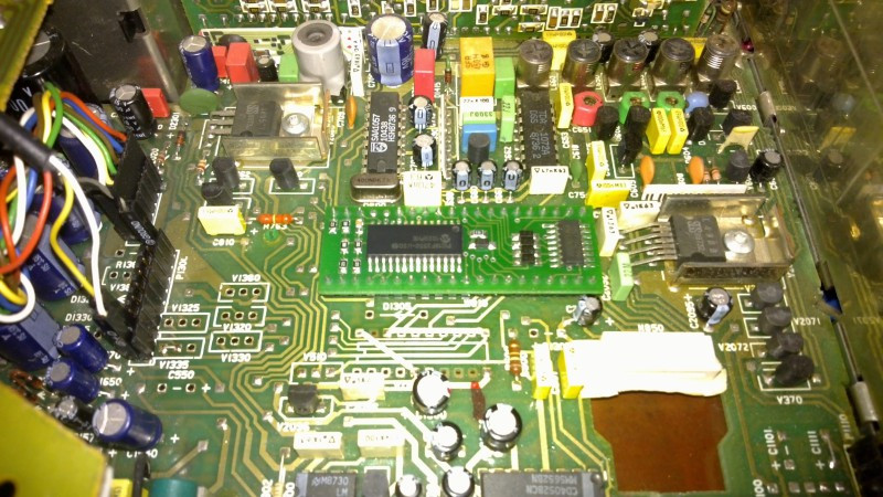

  3. It can be interesting to use cassette tray as phone dock. Thinking about it with my Audi Gamma’s III. There are a lot of fans of youngtimer cars, and most of them want old original radio with nowdays features. So far I’m on this road and have some success with pin-to-pin replacement of radio’s CPU with PIC18F2550 module. This gives me ability to fully control every piece of radio (including display and frequency synthesizer) over USB. Looks like this: http://www.stanson.ch/files/Audi/AudiGammaIII/processor1.jpg works like a charm. Without USB control radio works as original radio using PIC as processor for tuning, buttons etc. Marsboard (clone of Cubieboard, but with adequate connectors layout) with Linux on board can get control and do anything, including playing stored music. Still thinking about docking the phone into cassette tray.

          1. Nearly all functions written from the scratch, looking into IC’s PDF’s (freq synth, mostly) and schematic of radio. Only one thing I really reverse engineered was custom display – I just use oscilloscope to view how many bits original CPU sends to LCD over serial bus and then play with that bits in stream to find out bit-segment connections. Really most of things documented in plain text and circuits, so I’ll put them to my site here: http://www.stanson.ch/index.php?page=files&dir=Audi/AudiGammaIII
            I thought than nobody will be interested in such highly specific modification, because it is applicable only to Blaupunkt Audi/VW Gamma III M327 and may be to the Audi Delta II M330 which use nearly same hybrid ceramic CPU.
