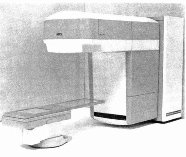

The Therac-25 was not a device anyone was happy to see. It was a radiation therapy machine. In layman’s terms it was a “cancer zapper”; a linear accelerator with a human as its target. Using X-rays or a beam of electrons, radiation therapy machines kill cancerous tissue, even deep inside the body. These room-sized medical devices would always cause some collateral damage to healthy tissue around the tumors. As with chemotherapy, the hope is that the net effect heals the patient more than it harms them. For six unfortunate patients in 1986 and 1987, the Therac-25 did the unthinkable: it exposed them to massive overdoses of radiation, killing four and leaving two others with lifelong injuries. During the investigation, it was determined that the root cause of the problem was twofold. Firstly, the software controlling the machine contained bugs which proved to be fatal. Secondly, the design of the machine relied on the controlling computer alone for safety. There were no hardware interlocks or supervisory circuits to ensure that software bugs couldn’t result in catastrophic failures.
The case of the Therac-25 has become one of the most well-known killer software bugs in history. Several universities use the case as a cautionary tale of what can go wrong, and how investigations can be lead astray. Much of this is due to the work of [Nancy Leveson], a software safety expert who exhaustively researched the incidents and resulting lawsuits. Much of the information published about the Therac (including this article) is based upon her research and 1993 paper with [Clark Turner] entitled “An Investigation of the Therac-25 Accidents”. [Nancy] has since published updated information in a second paper which is also included in her book.
History and development
The Therac-25 was manufactured by Atomic Energy of Canada Limited (AECL). It was the third radiation therapy machine by the company, preceded by the Therac-6 and Therac-20. AECL built the Therac-6 and 20 in partnership with CGR, a French company. When the time came to design the Therac-25, the partnership had dissolved. However, both companies maintained access to the designs and source code of the earlier machines. The Therac-20 codebase was developed from the Therac-6. All three machines used a PDP-11 computer.
Therac-6 and 20 didn’t need that computer, though. Both were designed to operate as standalone devices. In manual mode, a radiotherapy technician would physically set up various parts of the machine, including the turntable to place one of three devices in the path of the electron beam. In electron mode, scanning magnets would be used to spread the beam out to cover a larger area. In X-ray mode, a target was placed in the electron beam with electrons striking the target to produce X-ray photons directed at the patient. Finally, a mirror could be placed in the beam. The electron beam would never switch on while the mirror was in place. The mirror would reflect a light which would help the radiotherapy technician to precisely aim the machine.
On the Therac-6 and 20, hardware interlocks prevented the operator from doing something dangerous, say selecting a high power electron beam without the x-ray target in place. Attempting to activate the accelerator in an invalid mode would blow a fuse, bringing everything to a halt. The PDP-11 and associated hardware were added as a convenience. The technician could enter a prescription in on a VT-100 terminal, and the computer would use servos to position the turntable and other devices. Hospitals loved the fact that the computer was faster at setup than a human. Less setup time meant more patients per day on a multi-million dollar machine.
When it came time to design the Therac-25, AECL decided to go with computer control only. Not only did they remove many of the manual controls, they also removed the hardware interlocks. The computer would keep track of the machine setup and shut things down if it detected a dangerous situation.

The graphical representation of the defunct LINAC does not show the Therac-25. It resembles a Siemens Artiste LINAC.
For reasons unbeknownst to me, all the articles and videos covering the Therac-25 incident include images of LINACs that do not depict the machine in question.
Why is that so?
In most instances, a Varian Clinac or a Siemens Artiste is shown. Whenever a Therac is shown, it is the Therac-6.
This is what the actual Therac-25 looked like:
https://ocdn.eu/pulscms-transforms/1/JVkk9kpTURBXy82ZTNlZWVmNDM2MjI1ZWM3N2RmOGY4YTg0OTYwZTZlYS5qcGeTlQLNAxQAwsOVAgDNAvjCw5UCAM0C-MLD3gABoTAB
Unfortunately I could not find a color image.
However schematic representations of the Therac-25 LINAC bunker (where supplied) seem to be accurate with respect to the machine.
That’s okay! X-rays are colorless anyway.
If you’re into Therac-25 stuffs, you’re very lucky today.
here’s 4 rare pictures of the machine.
https://imgur.com/a/0mcPTMO
Thanks a lot!
