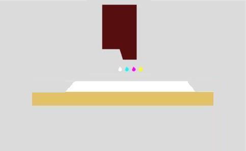

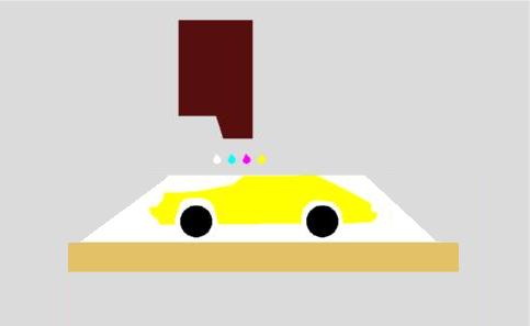

Most hobby 3D printers are based on FDM, extruding a single-color noodle of melted plastic to build up an object. Powder-based inkjet 3D printing allows you to print detailed, full-color models from a plaster-like material. The process uses ink and water droplets, dispensed from an inkjet print head to selectively fuse and color layers of a powdered binder material. When you see an offer for a 3D printed miniature version of yourself (or someone else), they are made with powder. [Aad van der Geest] wants to put this technology on your desktop with ColorPod, a kit that converts your FDM printer into a powder printer.

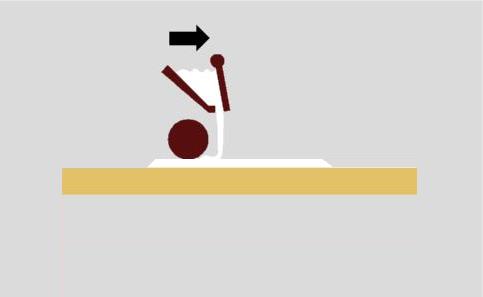

On the hardware side, his solution consists of a special printhead — shown in the header image — that mounts next to the extruder nozzle of an FDM machine. The printhead features a powder dispensing mechanism and two off-the-shelf HP inkjet cartridges. One of them contains water, the other one can be used to color the print. The powder dispenser employs a pager motor to sprinkle down fine layers of PVA powder while a spinning roller to evens them out.
Unlike industrial machines (and the one [Aad] built in 1998), which print objects in an enclosed, piston-like build volume, [Aad’s] addon simply prints the object within the heap of powder it lays down on the build plate. [Aad] provides PC software that processes 3D models from the STL and OBJ format into printable G-code and streams the instructions to both the printer and the addon. It also generates support walls around the model to stabilize the powder heap.

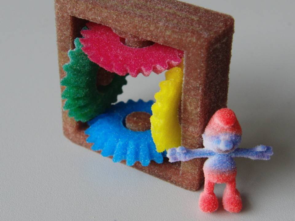

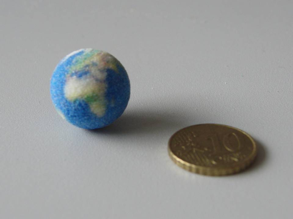

With the hardware working, [Aad] now sells his add-on kit for $488 ($349 for the PCB and $139 for the rest of the kit). Looking at the commercially available powder bed alternatives, [Aad’s] desktop-capable solution is underbidding the competition by about $50k. It’s certainly not a mature product and PVA dust and explorative goodwill pave the way to success, but [Aad’s] results speak for themselves. He made it work, and he’s providing us with tools to do the same. Check out the video below where [Aad] demonstrates the working kit on an Ultimaker 2.
The prints look like sugar covered sweets, I don’t think they would taste as good as they look though :(
No, but sugar is actually one of the materials his site lists…
*eats the wrong 3D print*

Definitely in the “look at this pretty object” category of printers, which can be valuable for test-fitting designs etc. But I’ll stick with FDM for things that need to take a beating.
If you are a commercial architectural (or other concept design) company selling how good your designs are, this is a really good alternative to either forking out for a very high priced machine or paying (usually through the nose) for a 3D printing house to make it for you.
Strength is not the goal – pretty models you can hold and impress clients with is. That makes the dough – not ugly, low resolution, but high strength, single colour models.
These models don’t really look that good. If you’re developing an architectural model, it needs to look nice. It’s an investment. Spend the money and get quality. This add on is a great concept, that needs significant refinement, or a method to smooth out the surface, equivalent to acetone on FDM.
