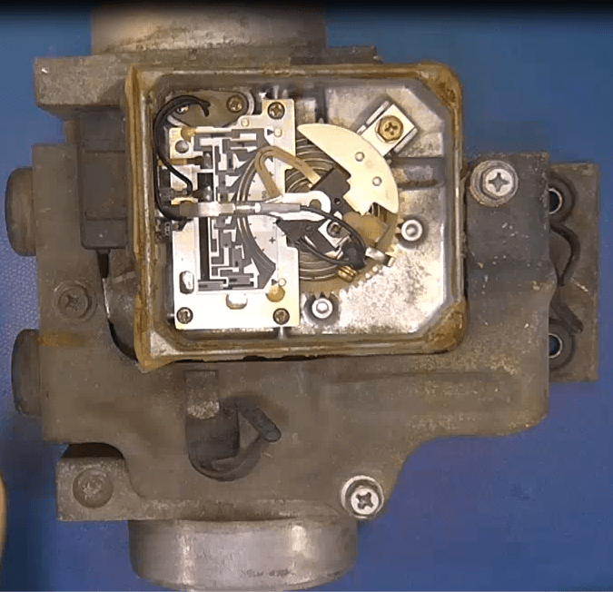

My original Z engine measured the air flow with an inline Volume Air Flow (VAF) sensor that actually (and unfortunately) obstructs the flow of air in the process. This works by measuring the drag force of the air moving on a spring loaded vane. We call this arcane thing “the flapper” due to the way the vane flaps open and closed while operating. As this method measures the volume, the temperature of the air is as needed to determine the mass of the air.

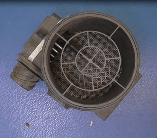

An alternative way of measure the flow of air is the Mass Airflow (MAF) sometimes called a hot wire sensor. The simplest description is that it measures the cooling of a heated piece of wire by measuring its change of resistance or the change of current that is required to maintain it at a set temperature. The flow of air across the wire removes the heat (think thermodynamics) and it tends to rule out the effects of temperatures as it more directly measures mass not volume.

  7. Note using MAP instead of MAF is not better, it’s just different and better systems use both a MAP sensor and a MAF sensor as you can get even more control over the combustion with information from both. There are threads out there to add both sensors to a GM7730 ECM or a megasquirt, the two most used ECM’s for car engine management hacking like this.
    Anyone doing this I really recommend using the latest megasquirt as they are far more capable and with the extra money. the MS3 on it’s own is massively superior in knock sensor and a Megasquirt3-pro is the absolute best you can get if you want a sealed and ready to go unit.
    1. In the older cases like this, map is better than maf, because the airflow sensor is so restrictive, as Bill says. They’re also very temperamental.
      1. flapper MAF is restrictive, hot wire not so much. The advantage of MAF is that it is a direct measurement, with MAP you need to take the temperature and varying volumetric efficiency into account
        1. MAF’s still measure temperature, the resulting fuel map is basically a map of volumetric efficiency (it’s called the VE map in MS). TBH it’s just two equally fine ways of measuring – and many modern cars use both MAF and MAP sensors.
          One issue that can hurt hotwire MAFs is oiled air filters, seen a few people kill them by fitting an oiled K&N filter.
          1. Only from over oiling. I ran an oiled filter for years on a MAF car no problems, because I’m capable of following directions.
        2. I’d just get a map sensor off a late 1980s to early 2000s GM V8 since it’s common and can be found at a any parts store and should flow more than the i6 will ever need.
    2. I mention this more in the video to the point where the MAF I show was good enough for a BMW M3. The MS can also do other methods such as actually using the throttle position with other parameters.
