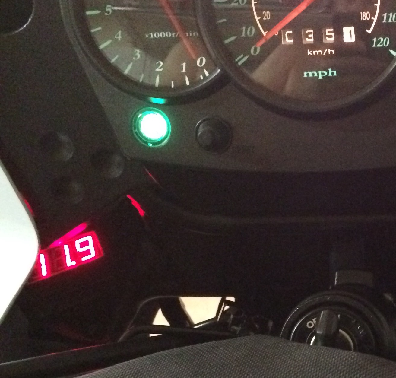

  3. WhiskeyTangoHotel Great job. As a biker for 50 years I BELIEVE in bright lights. My problem is current draw from the charging system. Is there any way to sustain 14.8 volt @ 3000 rpm charge while running things like aftermarket lights? I’ve learned a lot about a 3phase AC stator to MOSFET voltage rectifier to DCV, but don’t understand how to balance/boost the current to compensate for the draw of extra lights. Can a VR be adjustable?
    1. The rig draws a little less than an amp at 100% (full) bright. Less, of course, in the other modes. I have a voltmeter attached to the KLR (see: http://1.bp.blogspot.com/-U7iAz8zWiu0/VXEEQ6n62lI/AAAAAAAAZAM/0rnbFbkWyi8/s1600/FullSizeRender-717508.jpg) and it’s has no problem staying above 14VDC and the KLR is not know for it’s superior charging system. ;) Bottom line, the rig doesn’t pull very hard on the bike’s sytem.
