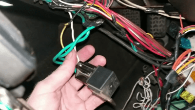

A Tale of Relay Interlocks
The vast majority of car alarms and immobilizers prevent the engine from starting in a very simple way. There are various wires that, when cut, will make running the car impossible. For example, if you cut the wire that runs the fuel pump, the engine won’t get fuel and can’t run. Cut the wire running from the ignition switch to the rest of the car’s electrical system, and the whole car loses power.
Diagrams indicating typical alarm operation in both the armed and unlocked states. Credit: Lewin Day
When installing a car alarm, these vital wires are cut. Each end is then connected to a relay, controlled by the car alarm. When the car alarm detects the proper keyfob or other signal, it closes the relay and allows the car to start. If the car alarm instead detects someone trying to start the car without first disarming the system, it will open the relay, no longer allowing current to flow. In the case of my car, with the relays connected to both the ignition switch and the fuel pump relay, the whole car just goes completely dead, save for the now-blinking alarm. Oh, and usually a siren will go off, and your neighbours will hate you.
So, how do we go about removing a car alarm? It’s as simple in most cases as identifying the wires that have been cut, removing the relay, and splicing the cut wires back together. This sounds easy in theory, but the shoddy nature of most installs and the absolute wire spaghetti that results can make it very difficult. Expect to face off against bare wires twisted together with tape, solder joints that are entirely uninsulated, or the dreaded Scotchlok (TM) connector.
This relay was used to cut power to the fuel pump. The green wires were spliced inline with the fuel pump’s 12 V line. The red and yellow wires are the relay’s coil wires, controlled by the car alarm. Credit: Lewin Day
RTFM (If You Can) — Then Clip the Wires

The relay which cut the fuel pump was buried in the driver’s side kick panel, making an unsightly lump under the carpet. The relay had two fat green leads that were spliced into the blue wire supplying the fuel pump. I took the liberty of cutting the relay out, and twisting the two ends of the blue wire back together.

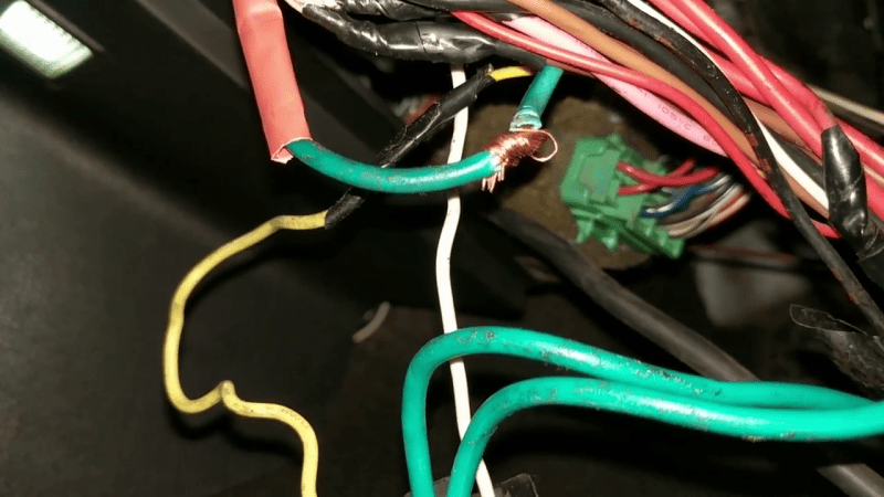

This nasty fella was tucked up under the steering column, spliced into the circuit coming from the ignition switch in the ON position. Credit: Lewin Day

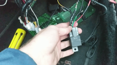

Next, I tackled the second relay, buried under the steering column. Spliced into the ignition switch’s ON wire, it completely shut down the car’s electronics when triggered by the alarm. Again, I cut out the relay and twisted the original wire back together. I was careful to make sure the bare wire wasn’t shorting on anything before I tested my work.
A quick turn of the key, and the car sprang to life! I’d successfully managed to remove the immobilizer part of the car alarm. All that was left to do was to solder the wires back together.
I no longer had to worry about my car being disabled by a failing keyfob or an oversensitive alarm. I decided to leave the rest of the alarm in place for now, sans the control box which went straight in the bin. The next few weeks will see me gently peeling out the rest of the alarm hardware, which interfaces with tilt sensors, brake switches and door locks.
The wires were twisted back together for testing, before being soldered in a linesman splice and covered with heatshrink. Credit: Lewin Day
