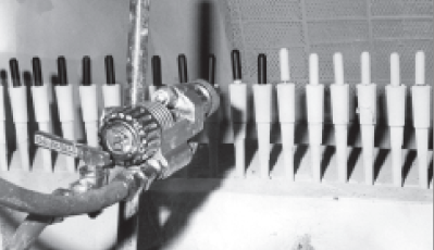

![](https://hackaday.com/wp-content/uploads/2018/06/painting.png?w=400)
With rocket fuel sitting inside a thin metal casing, one would want an insulator to ensure the outside surface of the fuel grain didn’t ignite and burn through the casing. MBA tried many chemical compositions for this, but found titanium oxide to work best. In a clever hack, they simply went down to the local paint store and bought the white paint which had the most titanium oxide. It happened to be Moore’s Number Eight. The paint was sprayed on the fuel grain, which was then inserted into the casing. The titanium oxide worked so well that other rocket companies began asking MBA how they were doing it. The answer was simple – head down the local paint store!
