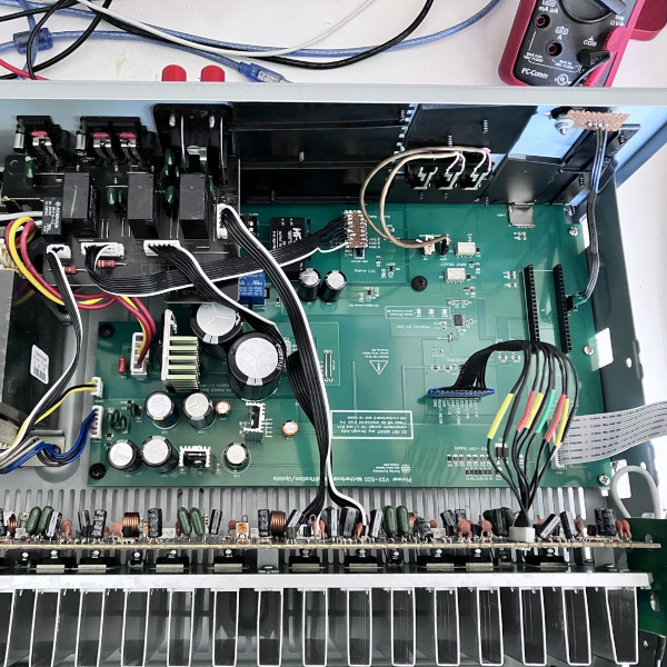

An audio amplifier was once a fairly simple analogue device, but in recent decades a typical home entertainment amplifier will have expanded to include many digital functions. When these break they are often proprietary and not easy to repair, as was the case with a broken Pioneer surround-sound device given to [Boz]. It sat on the shelf for a few years until he had the idea of a jukebox for his ripped CDs, and his returning it to life with a new main board is something to behold.
Internally it’s a surprisingly modular design, meaning that the front panel with its VFD display and driver were intact and working, as were the class AB amplifier and its power supply. He had the service manual so reverse engineering was straightforward, thus out came the main board in favor of a replacement. He took the original connectors and a few other components, then designed a PCB to take them and a Raspberry Pi Pico and DAC. With appropriate MMBASIC firmware it looks as though it was originally made this way, a sense heightened by a look at the motherboard inside (ignoring a couple of bodges).

    1. Pretty much correct, but in this Pioneer modal everything before the amplifier input goes through a propriety digital front-end processor for volume, DSP integration and input selection, and the Renesis micro controlling all this assets a fault signals that shut off the main +/-50V power supply and speaker relays if any of this does not work. So you either have to rip out or reverse engineer all of this or just replace the complex stuff causing the issue. Idea here was to keep it going into landfill and keep it looking as much as possible like the original so it would look good. Re-doing the motherboard without the fault-aware power supply and propriety micro let me re-use the good bits. I also re-used all the electrolytic caps to save money, all still good quality thankfully.

  2. Fair amount of output transistors , but I think it’s a high voltage amplifier , not a high current amplifier. Pioneer made good stuff , but they were never really known for super high current amps , especially something that small. I could be wrong, but the measurements would show the output current level.
    1. I’m confused about the “high voltage” vs “high current” reference. Most amps for home use are designed to deliver their rated power into 8-ohm speakers, sometimes built to handle 4-ohm loads. All their power supply voltages will be similar for a given power rating. Higher current and lower voltage amplifiers are typically seen in car subwoofer amplifiers, typically rated to 4-ohms, often 2- or even 1-ohm loads, but wouldn’t easily be confused with the unit pictured here. If there are common exceptions to the above then I’m curious what kind of units they are and how common they would be?
