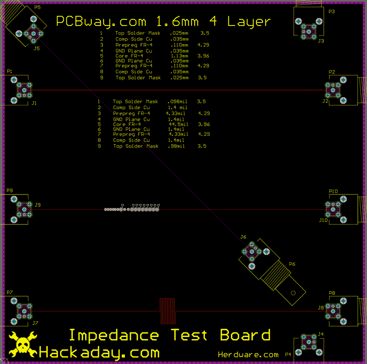

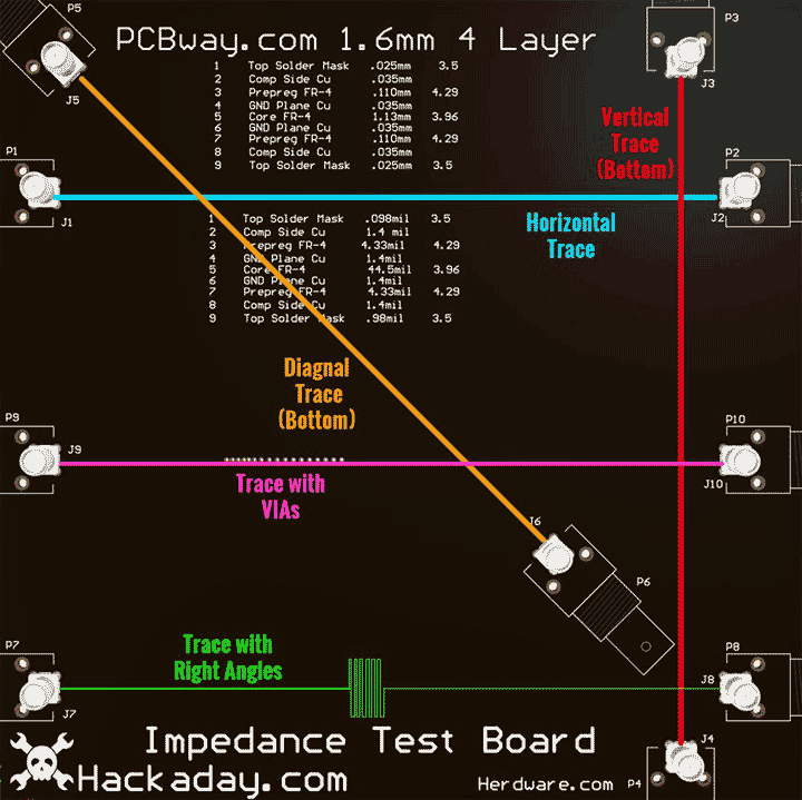

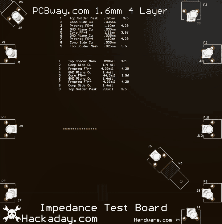

To continue testing some of my design rules listed in the beginning I built a PCB to test the impedance of different PCB traces.
PCBs are constructed of layers of conductors (typically  copper) and dielectrics (typically epoxy coated glass fibers). As speeds go up these materials become more and more specialized. Since the glass fibers or weave are uneven, they can have an effect based upon how the conductors interact with the weave of the fibers as shown below.
Simply put, traces that align directly with the row of the glass fibers will have a different impedance than the trace that experiences alternating bundles of fibers.
Likewise a trace in the vertical direction will see a different amount of glass under it than a horizontal trace due to the differences of the weave density in different directions. One answer is to spread the fibers out during PCB fabrication, but as you might expect, the price of the completed PCB starts going up.
One way to test the impedance of a PCB trace and to see changes along the path, is a high speed Time Domain Reflectometer (TDR).  TDR’s are commonly used at slower speeds as in cable testing, [W2AEW] has a very informative video on the whole theory behind it.

Horizontal vs. Vertical PCB Traces
As can be seen below there is a definite difference in the baseline impedance based upon the direction of the PCB trace.  See the video for all of the fun in setting up for these pictures.
You can see a definite and measurable difference in the impedance of the traces based upon the orientation of the trace on the board, in the case of this board the Vertical trace was off by approximately five percent.
There are a couple of techniques that help deal with this effect without the cost of going to a more expensive PCB with a tighter glass weave. My CAD software supports the two main techniques shown below to help automate the process but both can be done manually as well.  The first technique entails zig-zagging in a not-so-orthogonal way in an effort to statistically reduce the effects. If there is the option of laying out the PCB in a larger panel then it can be cocked to one side (I have heard 10-11 degrees but it is affected by other variables as well) so that again the sum of signals running down the worst case paths is minimal

Shocking Discovery: Square Corners Probably Don’t Matter
One of the factoids that plague the industry is the concern about what the effect of right angle corners used on PCB traces might have on the impedance of those traces. Other complaints are that the RFI emissions are higher with right angles and that acid can build up in the corners during the fabrication. I will put this board  on the spectrum analyzer and check for “EMI spray” in the next video post and if your PCB fab house complains about acid in the corners then I would humbly suggest that one find a different fabricator.
Right Angles have Minimal Impact on Impedance
Traces with Right Angled Corners Have Minimal Impact at moderately High Speeds
I set out to see if I could detect the effects of corners myself with my new 20Ghz capability. As seen above the effects of right angle corners at 20Gz (.35/17.5ps=20Ghz) with a trace width of 5.27mil (calculated for 50Ω Impedance) on the characteristic impedance are minimal.
Square Corners Mean More Capacitance, but Not Much

Just for the Heck of It.
Just for the heck of it I ran the same test only instead of corners I had “hanging VIAs” which admittedly are worse case as they are like little capacitors and antennas hanging off the trace.  I wanted to be sure to have something that would show up as an example of worse case when compared to right angle corners and this example did not disappoint.
Effect of VIAs on Trace Impedance
