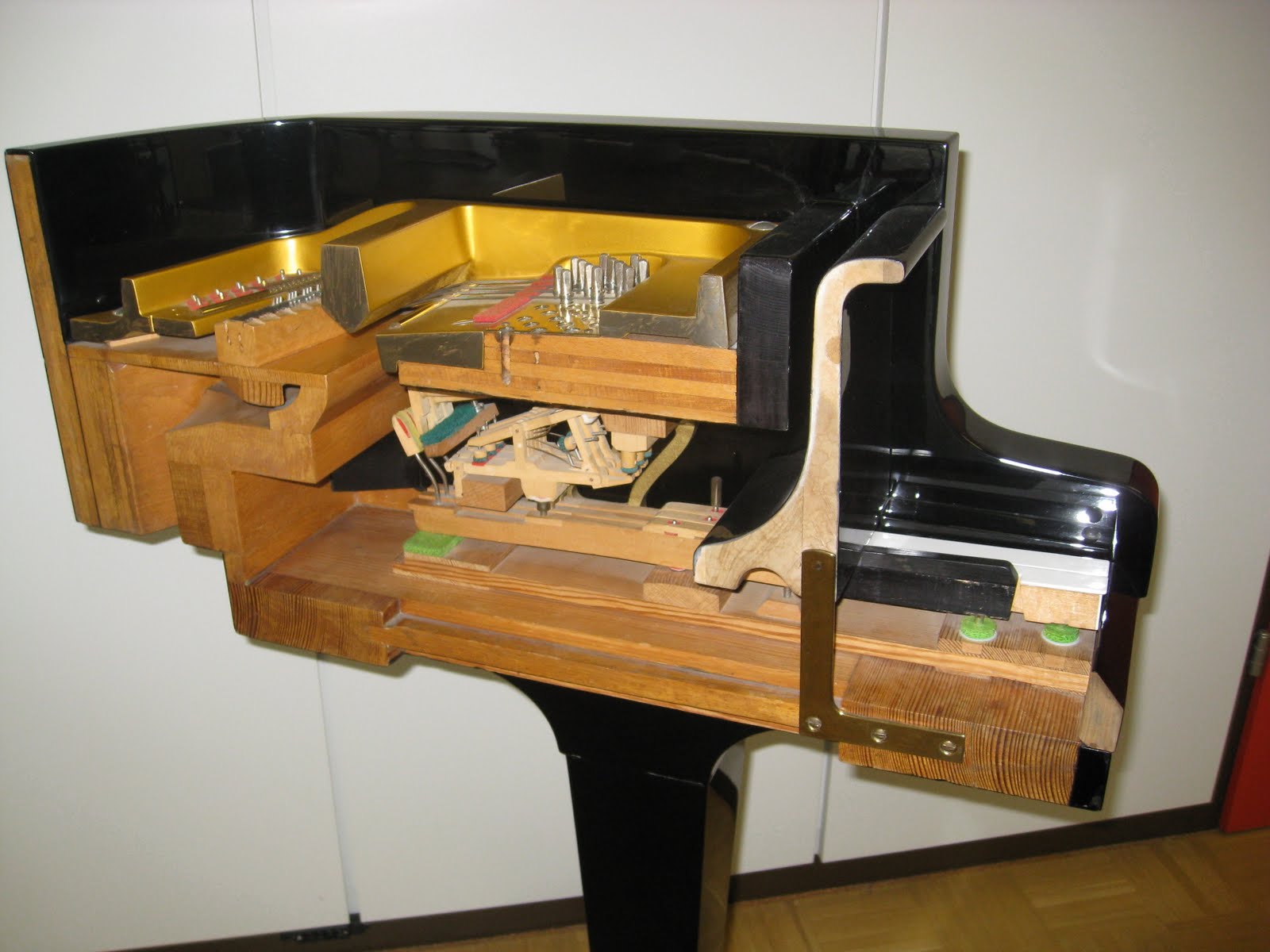

  8. For whatever it’s worth I totally dug the simple little hack. And now my brain is abuzz trying to think of how to seal the front and keep it working. All of my answers so far would really get in the way of the level of finesse a player needs., Hmmm…
    1. After some consideration I think you could cut each key right at the balance pin, then install a thread receiver on one side and a threaded rod from the other (maybe even through bold the whole thing) then install a panel with small holes for each re-assembled key, then put a thick membrane layer, perhaps silicone? the each key individually screws through.
      I think the membrane would resist motion of the keys based on water pressure, so you may have to put some sort of spring assistance system in place to make it easier to press down. Careful control of the membrane angle should allow the key to continue to rest at the correct angle. basically the membrane replaces the balance pin.
      In this image I think you can see about where the new water tight panel with the piercings would go. http://3.bp.blogspot.com/_6XEqqwDj1-c/TNrzsge8TdI/AAAAAAAADPg/Q_-hY5Cq8QU/s1600/IMG_4359a.JPG the panel likely couldn’t be flat and would have to be a three part assemblage, if that picture and the others I’ve seen are accurate, but mechanically it’s still just a panel.
      and here I think you can see where the balance pin, and therefor cut would be. https://i.pinimg.com/originals/67/43/f3/6743f31687d880e8c2f8ae5be4be4549.gif
